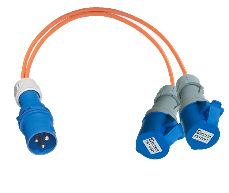

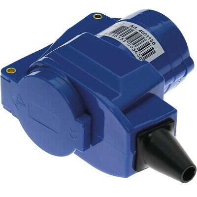

Probably doesn't comply with site hook-up rules, but how about one of these and one of these?
Run your usual hook up lead to the Y splitter it and place it under the van so it keeps dry.
Then a short hook up lead to run from one of the tails of the splitter to the van connection point.
And use the other tail on the splitter to connect the 13 Amp lug socket unit.
With a bit of Googling, it looks like you could get both items at a lower price than those shown in the links.

We changed the plug on the near end of our hook up lead to one of these then stick a travel adaptor in the outlet.
