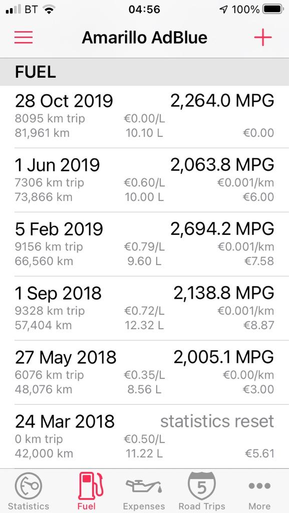

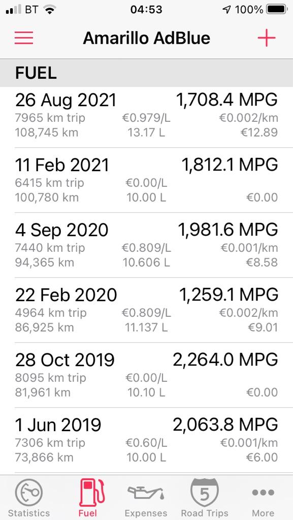

Here are my last few AdBlue refills.
And the ones before…
