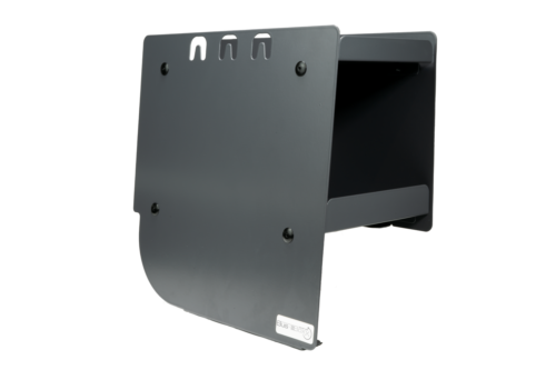

Here's my set up.. Made a slight naff but effective power set up and it connects to the 12V supply in the side next to the seat.. Switchable and removable when not needed.
Got the Shoe Rack from https://www.gruenthal-mobilcamping.de/ and can't fault them.. Excellent service.
I like that - would certainly solve one kid charging without routing cables and cutting trim. Pity the shoe boxes are so £££!!!

I like the shoe cupboard with sockets idea and ideally would get the bus-boxx one but I ain't paying £150 for it.
