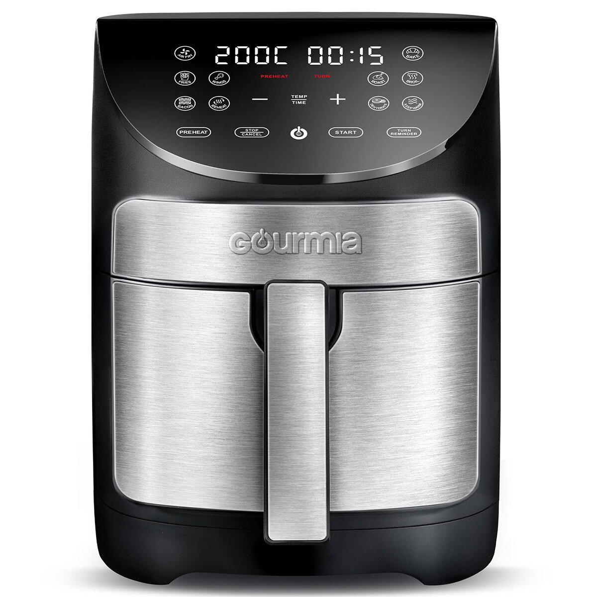

Does anyone who uses an air fryer on site have trouble using it on hook up ? I’ve not used mine even though I have space to take it for fear of tripping the site. Mine ( the Costco Gourmia ) is 1500w which I think needs 12.5amps to run. I’d be happy to be told I’ve got the calculations wrong.
Watts = Volts x Amps, so 1500w at 240v = 6.25 Amps
Ohms law
Think so. Ohms law has it that 1500w would draw 6.5amps (assuming 230v supply ). Not had any issues with our air oven on hook up.
Ohms law
Thank you Mr Ohm ( and Malc69 ). I will take it on my next trip and see how it goes.
