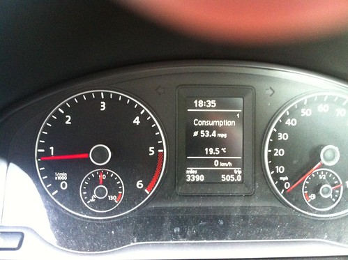

24 mile journey home tonight home tonight
Average speed 44MPH (Cruising at 55MPH on mway + traffic)
http://www.flickr.com/photos/syrup1971/7679033264/
you must have the only cali in the world with that mpg unless you was on the back of a tow truck fella ... :lol: :thumb
I was trying, but not too hard. Mostly trip set to 55MPH (so probably around 52MPH real speed), a bit of freewheeling down hills, and some 30MPH stuff on the M4 when the traffic kicked in.
Based on my trips into work (the reverse trip), where I struggle to get above 46MPG, there must be a few factors at play. I can only assume there is more downhill on the way home than the way in, perhaps the engine is warmer in the afternoon, having warmed up through the day, perhaps the prevailing wind also helps?
Anyhow, I don't expect to get that figure everyday, but nice to know it can be done ...

I picked up a 140PS Cali Beach and drove it 1.5 hours home along mixed quality A-roads (not motorway).
I averaged 36mpg which I thought was stunning for a zero miles engine.
Typical cruising speed was 55mph but lots of big hills, junctions, town traffic etc .
It's not that long ago I couldn't get that sort of economy from my cars.
