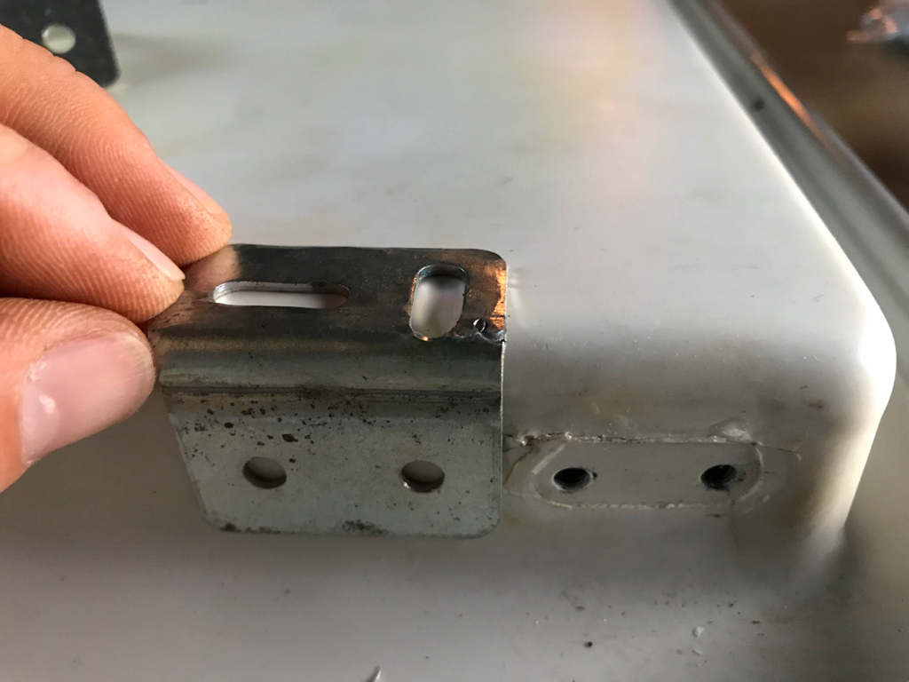

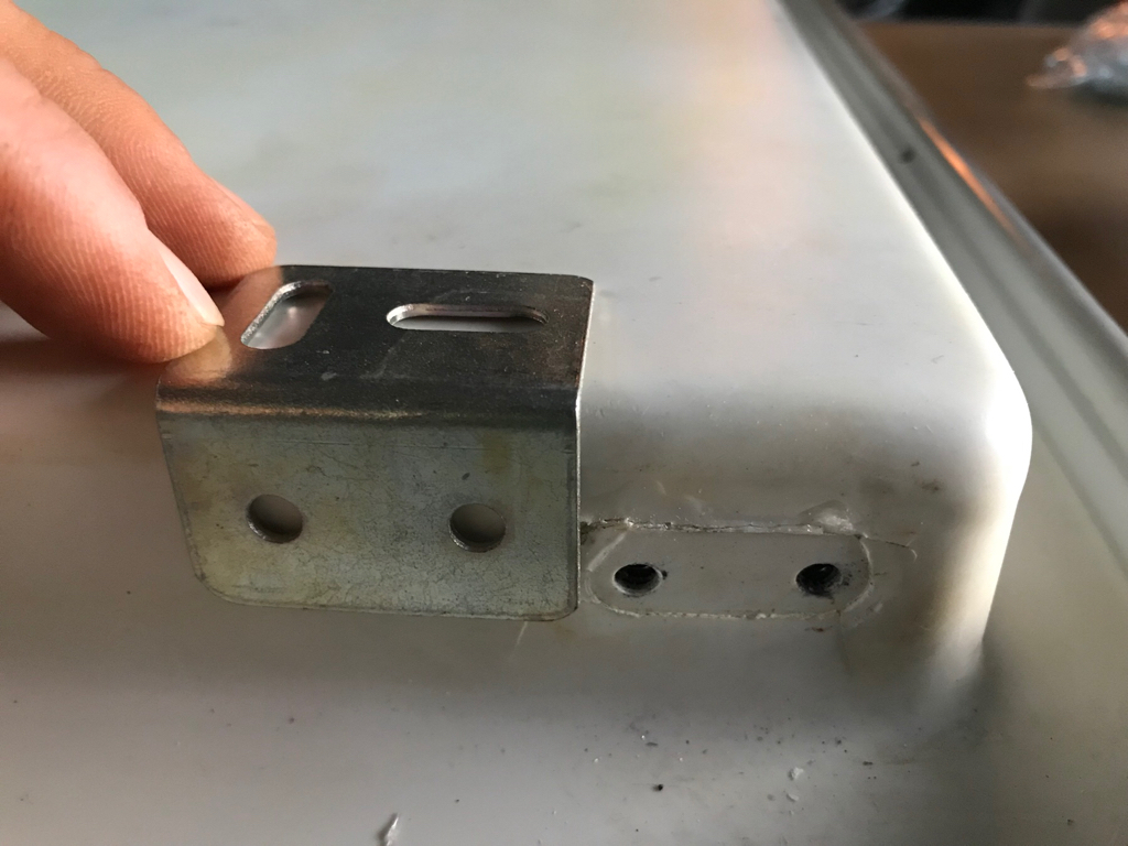

I wanted to reinforce the lid, as the bracket had damaged the plastic. Before experimenting with super glue and baking soda, I thought I’d attempt something a bit less exotic. After rummaging through my garage I found some metal brackets with holes spaced at a promising distance. ( I have more and can post to anyone who wants one )
However, it required a bit of hammering in a vice to allow enough room to clear the bottom of the lid. I will hold off adding a screw on the bottom of the lid, as for now having extra support there seems to make it solid enough without having to add one and the default screw locations seemed to have metal female bits in the lid to hold them better.

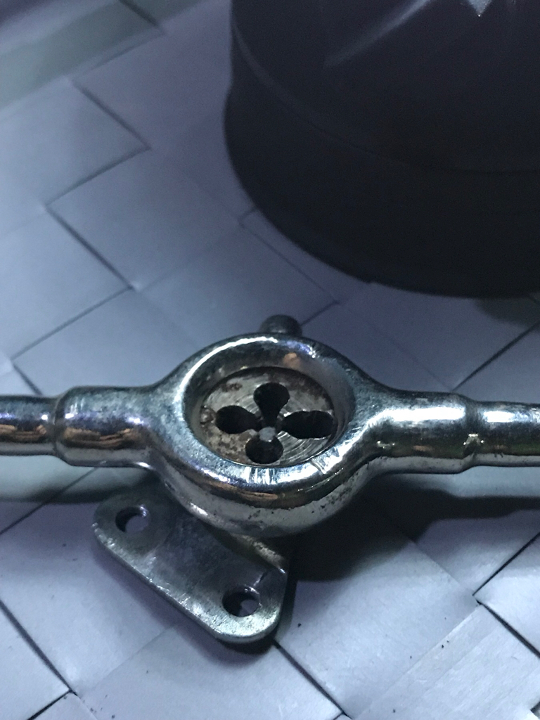

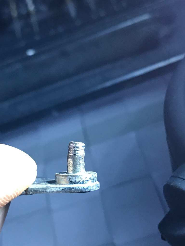

With that done, I wanted to ensure the new strut stayed on, so my solution was to simply thread the original bracket pin with a die. It had a number 3 on it, I just used the biggest one that seemed to “bite” to ensure I didn’t thread it too small.

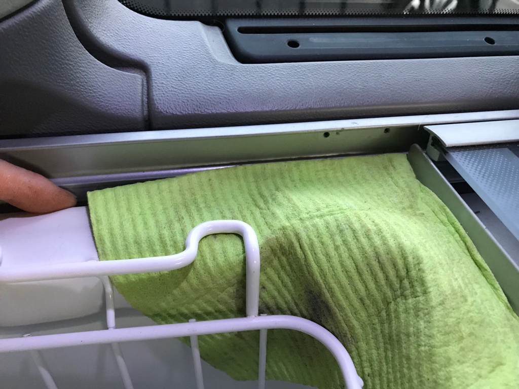

BTW I also made sure to stuff the crevice behind the fridge to ensure I didn’t lose any screws (with a magnet for good measure). That tip was from another thread.

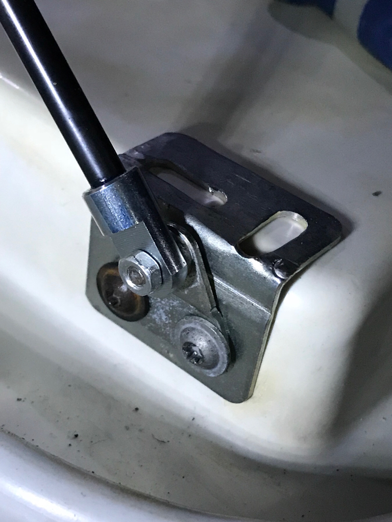

Here is the result. The SGS strut is quite a bit fatter than the OEM part. Be warned as it rubs against my rigged lid bracket and a bit against the side of the fridge which might stress the fridge bracket, but for now it’s better than before!
