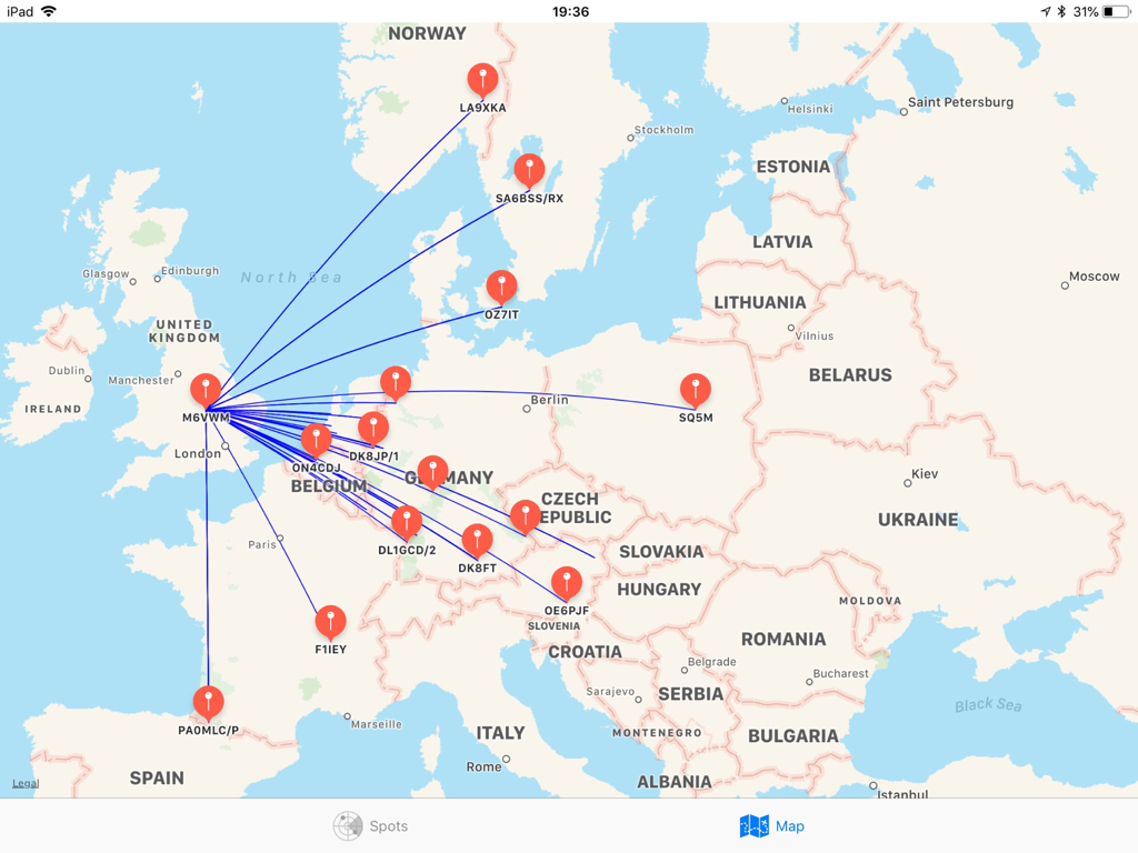

When the propogation is good I am getting into Moscow, Italy and Eastern Europe. Also been hitting germany and norway quite a bit too.
First ever contact last weekend was a chap just north of Hamburg.
Up and running at home now, bands are poor but I’m getting out.
Had some contacts in Moscow today :)

Recently upgraded my rig to a 7300, wow great piece of kit and put up a home made inverted L. I've been hitting USA and even Australia on digital modes so pretty interesting stuff and managed voice to Israel and Iceland.

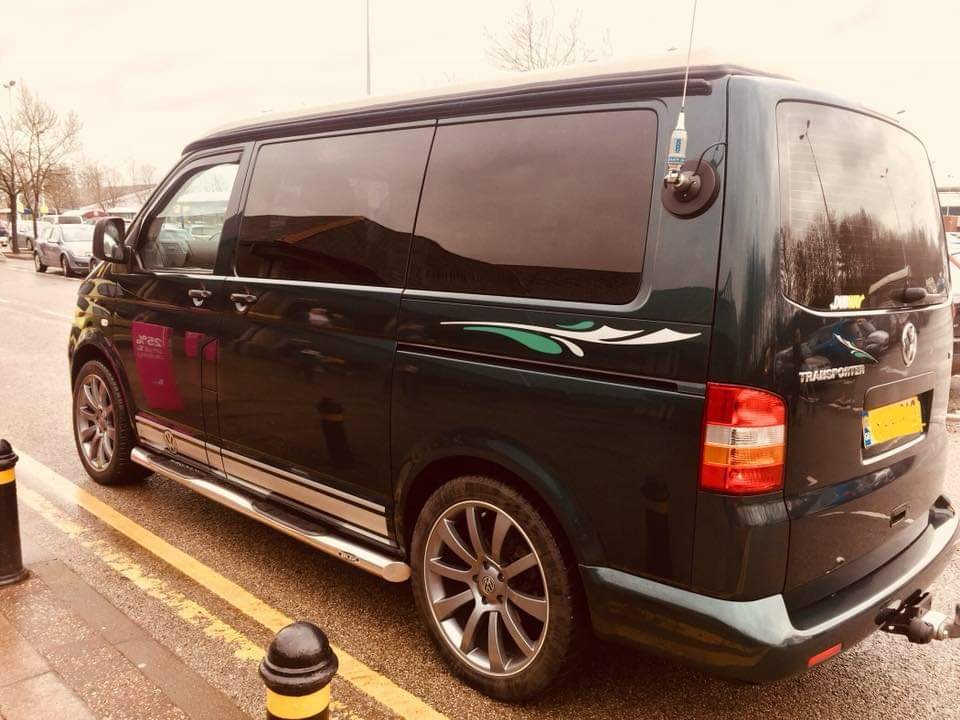

I love the idea of a rig in my van, would probably be my Yaesu 857, now this would go beautifully with a Yaesu ATAS 120 but I can't really work out where to mount the thing. I have seen one guy with an interesting setup that lay down when not in use on the roof... could it work? Mga mounts are useless on a cali as the roof is aluminium.
G1JJT, 857D, not put the rig in the Cali yet, used to have it in my landy, worked the Isle of Man from Spain's Atlantic coast, and Yorkshire from Iceland using an ATAS.
Where did you mount the atas on the landy?
Swapped it about, (Landy was a disco 2) when on tour it was mounted front centre on a full length Aluminium roof rack, but daily running on a bracket fixed to the spare wheel carrier with dual band 7/8ths mounted from the roof rails.
I am thinking on a Cali it may need to be on a tow bar mount? I understand the earth needs to be very good for it to work effectively. Not sure if that would hinder its performance.
I've got hold of an ATAS at a decent price and just waiting on a hatchback mount to arrive. No idea how I am going to route the cables and where I will put the rig? Under drivers seat maybe.

I am aware that a good earth is crucial of course the aluminium roof means a mag mount is useless. So it a boot mount and a good sturdy earth to the body somewhere.

What about some sort of bracket to clamp it into the roof rails?
yeah I must admit using the rails would be good, just not sure if such a thing exists, ideally something I could drop down 90degrees when not in use would be good too.
You could slide a couple of upside down bolts with a washer each side, tighten up a nut from the top and leave enough bolt thread sticking up to attach a bracket to, maybe. I'm not familiar with the fixings of the ATAS. You could run the coax along the channel and in through the grommet on the top nearside rear door opening.
BTW, if it makes cable routing easier you can use that thin (3mm?) coax, not sure what the designation is, RG158 seems to come to mind. Over the short run the losses would be negligible, I've been using it with the linked dipole no problem.
Just a thought, you woudnt be able to open the tail gate with the roof up and antena mounted.
Yes I agree it will to be relatively low down unfortunately, unless I can work a way of putting it on the roof rail.

The Mag mount looked good and I guess for VHF/UHF it could be stuck on the cali anywhere when parked up
the Awning Rail looks good for a stury fixing but it is not grounded to the Cali and it seems to have a coating that is not conductive, tested it out with my continuity meter and got nothing.
there are Thumb Screw ites availible for the rail that a fitting could be mounted on indeed a pair of them could be positioned to support a vertical , still thinking about this !
