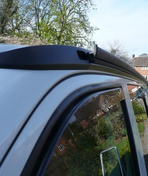

Hi there, notice in the original posting you mention you've not got the wind out awning. VW do a rubber gutter strip that fits in the awning mounting rail when you don't have the wind out awning. (It's left in place permanently)
Sometimes called a "rubber holding insert"
This has got the normal slot for the Kador beading in its lower edge.

I'm glad to hear I'm not the only one having this problem, from experience (after having the California awning rails fitted to both sides of my van), it seems there primary purpose is to hold a pull out awning.
I then bought the genuine rubber strip from Bawny:
http://www.banwy.co.uk/product/t5-parts/california-parts/awning-rubber-insert-california-awning-rail
However the "C" cup in the rubber section is around 9mm, (where as the standard sizes of "C" cup (to mate your awning with your van) are either 4mm or 6mm, so I had to buy an additional Awning tape / Kador strip, the closest Kador adapter I could get is a 7mm to 6mm from Khyam.

I am assuming you do not have a wind out awning? If so, you need one of these
https://vwcaliforniaclub.com/shop/p...nsert-c-channel-attach-drive-away-awnings-etc
I have just tested our ones that we have in stock and 6mm kador fits perfectly
