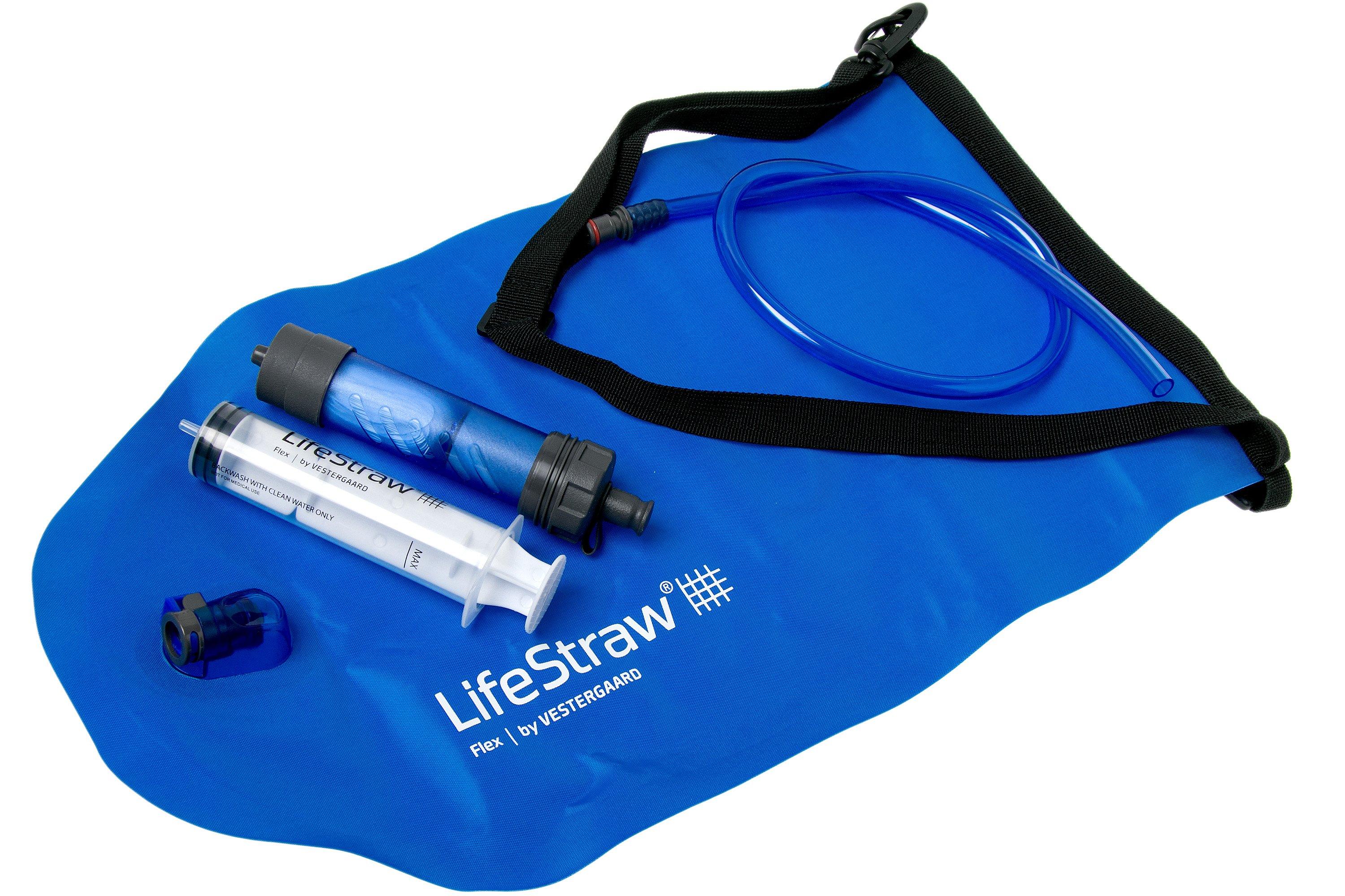

Hi I’m looking to make or buy something which will slot into the near side awning rail on my T6 Cali, so that I can hang a gravity water purifier from it and allow the pure water to drain into the van’s fresh water tank. Has anyone done this or seen anything suitable?
Yes exactly! I was going to get a Lifestraw Expedition or something like that, so hopefully I can buy just the hook on its own.

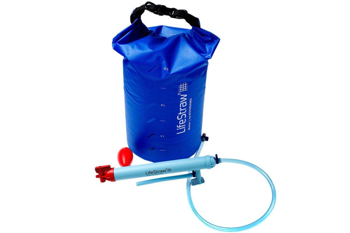

OK I think this is the purifier I'm going to get. It's going to be heavy at 12L capacity, but I don't need to fill it right up, and the big one is only £10 more that the 5L one. Now I need to find the hook ...
