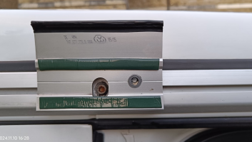

Green strips are draft excluders. Stopped the noise dead for 3 months after a constant hammering to my right ear. But the weight of the awning caused it to start again (so a thicker or denser product would be better). It was bliss whilst it lasted. Ignore the top tape / this is not required as the awning is a wedge fit into a small channel (so cant move).
As the noise started again, I cut a store card and shimmed it at the bottom (cut out a V notch to miss the fixing )....noise gone again
Awning is a PITA to replace on your own and awkard. Easy to remove
Isolates the metal to metal contact with the flex in the rear casing and the single fixing onto the bracket - oddly the rear mount doesn't make a noise
