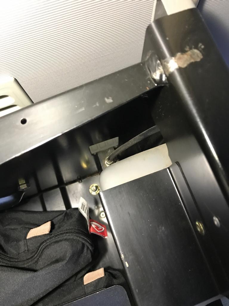

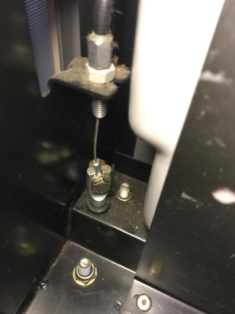

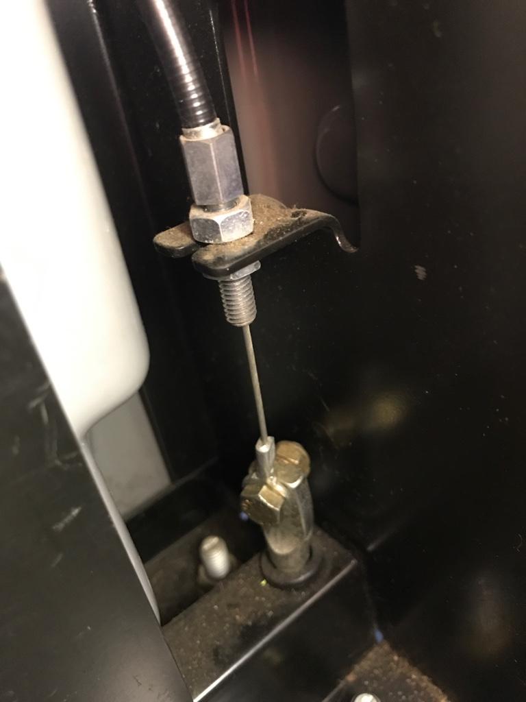

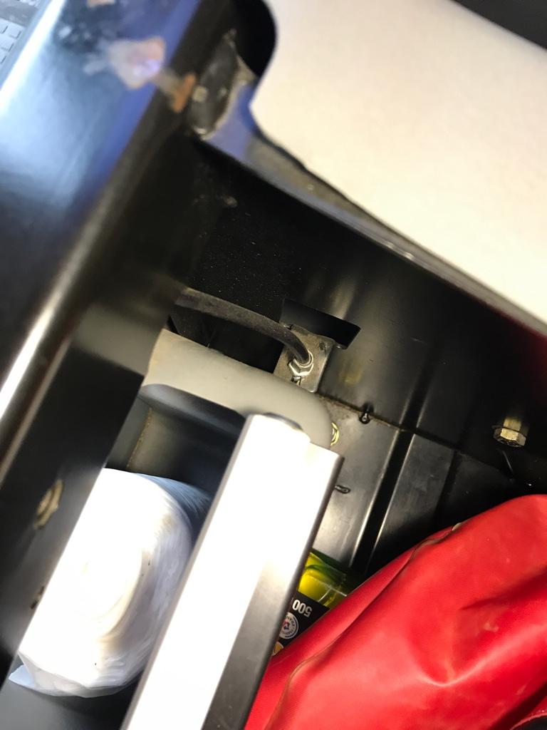

Hmmm. That’s sounds problematic. I’ve had a look at some diagrams and it sounds like you might have issues with one or both of the cables the lever operates to release the seat so it can slide. You might be able to lift the locking pins manually to get the seat moving. See the photos below, the pins are in a pretty tight corner but you should be able to lift them. One on each side so it might be a two person job.
That’s good news. I think sometimes these cables and pins don’t get any servicing so get a bit sticky.
If you’re still having trouble with the mechanism for tilting the seat you might want to remove the seat from your camper, unscrew the plastic trim panels and give the mechanisms a good clean and some light lubrication. Again, they rarely get any attention and are often clogged with years of dust and fluff. I’m pretty sure that doesn’t help their operation.
