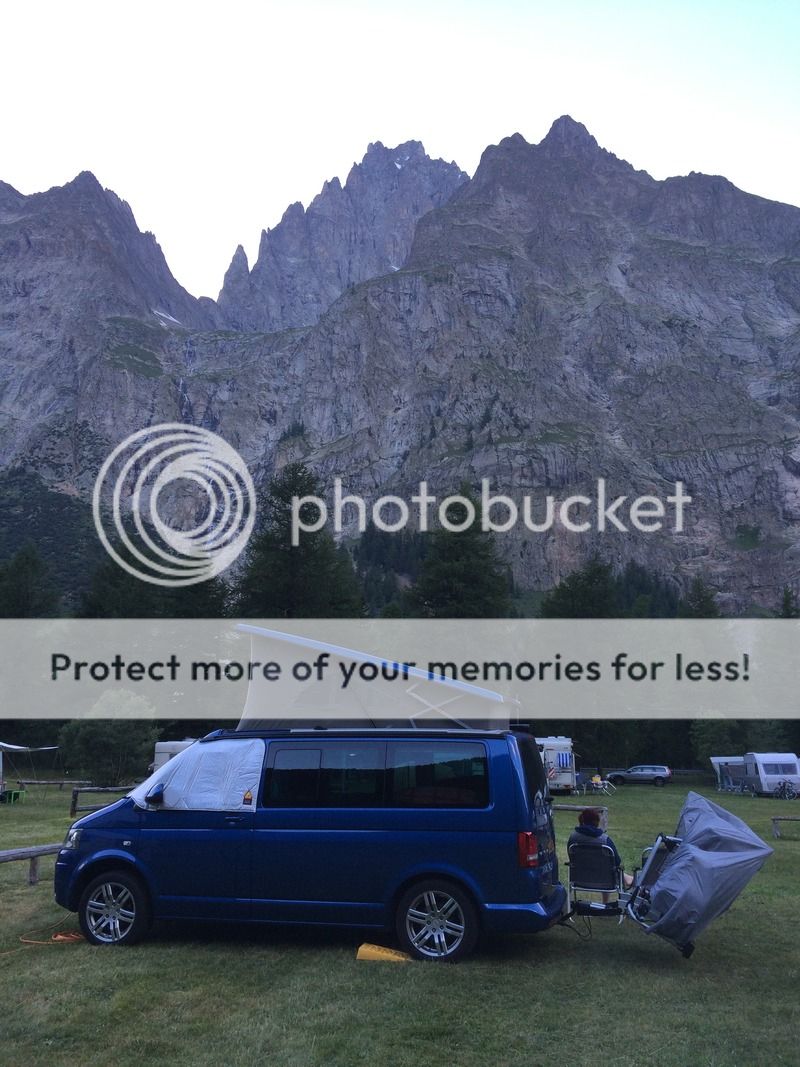

i have recently bought a Cali (T5) and had a west falia detachable tow bar fitted (by the dealership) as we already had a Thule tow bar bike rack (euro classic G6 929). Anyway love the Cali and the bike rack except we cannot open the back door when bike rack is tilted ( we are 2-3 cms out). Seen on other threads that this bike rack works on other calis and so cannot work out what we are doing wrong? Are we using the wrong tow bar? All thoughts welcome.

Looks to me like the ball is slightly closer to the van than my fixed Westfalia bar. That would make the difference. Can you flex the bike rack away from the van to clear the door?

Thanks both will go and have a look. Just realised though that I did not add the key photo - doh. So attached incase that gives others any ideas. As it is not the problem getting the bikes on - just cannot open the door when bike rack tilted. However sounds like fixed tow bar may be longer than our detachable ( will investigate ). However where is ' a ' bracket on bike rack.
On your middle picture, it is the 'A' shaped section adjacent to the rear door that the clamps attach to. Look towards the bottom and you will see that the position can be adjusted (this from memory so can't be specific as to what it does)
Doesn't look to me as if that will ever adjust enough to be able to open it. It's the rack, not the towbar that is causing the problem.
I can't post any photos of ours until next weekend, but now I can see that your's is a different type and the the whole assembly is closer to the van.
The Thule Euro Classic G6 is the only one they state is designed for 'even very large rear door' so should be OK.
Looking at the picture in the brochure the bikes tilt to almost horizontal. Does yours do this?

A big thank you to all - a combination of your comments has solved it. For those interested we moved the bracing wires ( which hold the bike rack in place when tilted) this changed the angle of tilt from 50 degrees to 70 degrees ( frankly we should have read user manual for this one as it is included ) in addition if you make sure when you clamp on the bike rack it is horizontal and not slightly up at the back then we have about 5 mm clearance!!!! Now sitting on campsite in thetford with glass of wine feeling particularly happy about sorting out this one. Thanks!!
