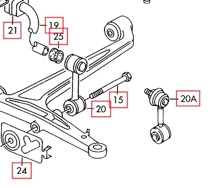

Seems there are two ARBs that VW used - 23.5mm or 27mm. Judging by this diagram you can tell what size you have fitted by the type of droplink used. Item 20 for 23.5mm or 20A for 27mm
