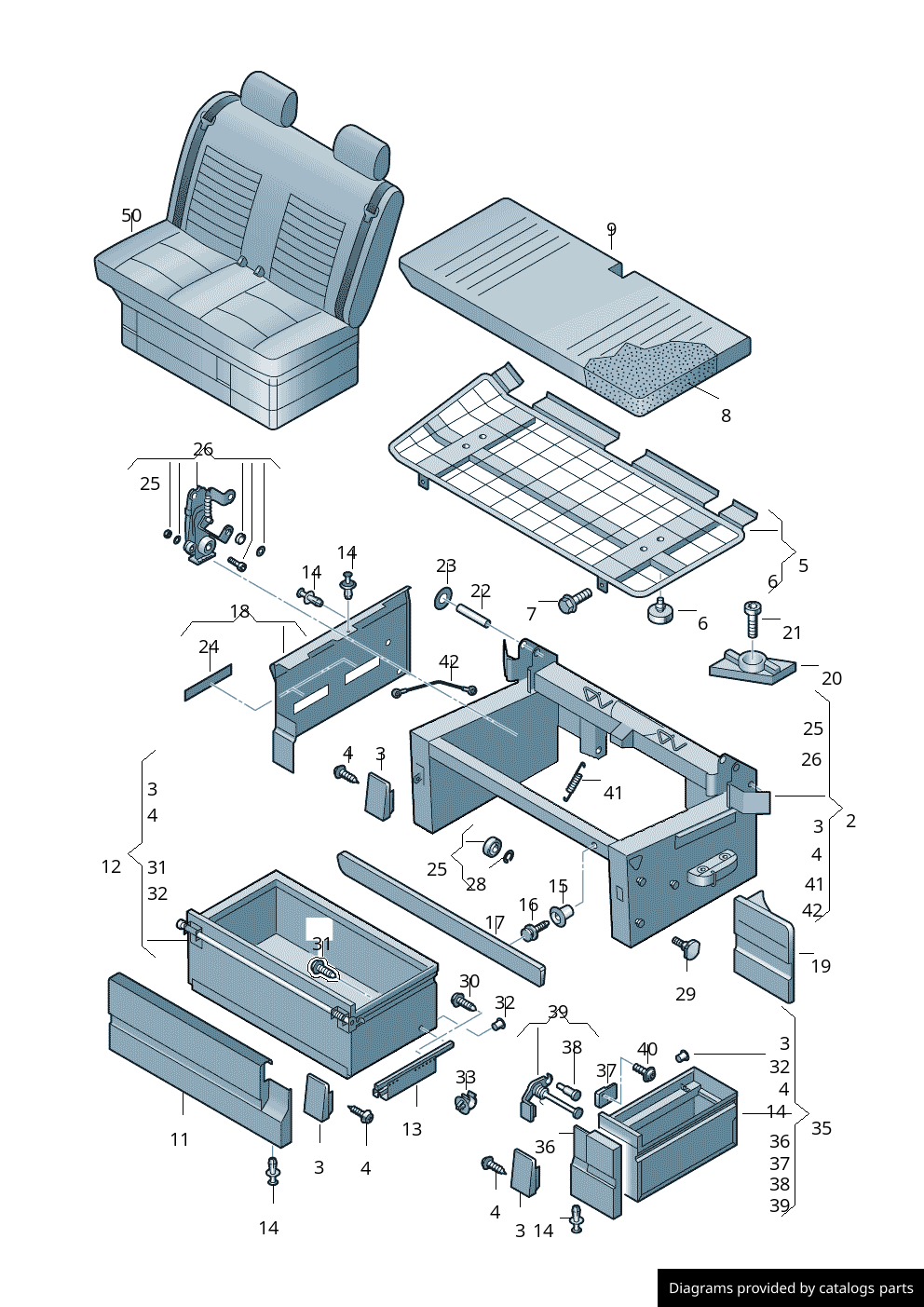

The drawer under the sofa bed of my T5 from 2005 no longer locks, a torsion spring on the right side has broken off, the dealer in the Netherlands cannot/will not supply this, just buy a new drawer (€ 900.00) they say. Does anyone have a solution for this or a company that supplies this torsion spring?

Have you checked the catalog for spare parts and then order? Check out lllparts online.

It appears that part is not available on its own.
versa.
Select year then Access and scroll down.
You will need to measure the torsion spring with a digital Vernier and then see if you can find a replacement
Get one made. The company mentioned in this thread can sort you out.
