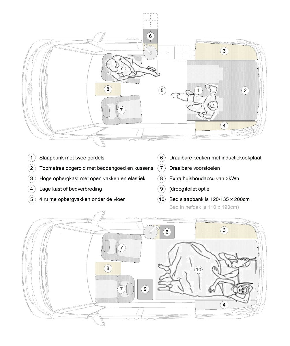

at Outbase campervans in The Netherlands they are also "buzzing" (and building) a ID Buzz Campervan. They state that they are doing this in coordination with VW (@ArunAlec).

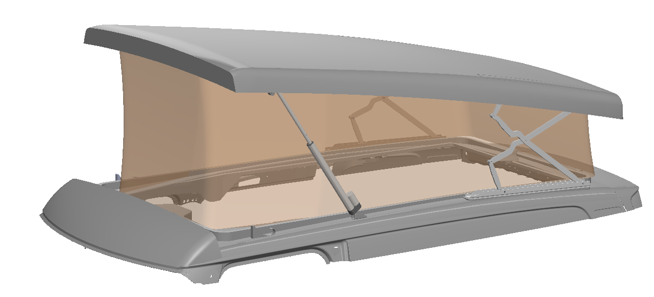

They want to make it a 4 person campervan, so also a poptop where one can sleep in.
Including a 3Kw extra household battery and reversible front chairs.
First impressions;
2 berth (barely though, the bed looks very small?) and even less storage than the Cali. Looks ideal for a solo camper only. Hard pass from me.
It says the bed size is 1200mm wide. Comparing to the Buzz boot width, which is 1275, the bed looks significantly narrower to me, more like 1000mm. That’s excluding No.4 on the diagram. Also worth noting that the Buzz appears to narrow towards the rear, which leads me to believe VW will craft this into a very cleverly designed Beach style California. It’s simply not big enough to try and squeeze a full sized camper inside.
