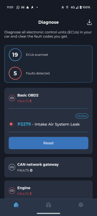

Then on the way home, the Cali goes into limp mode and the flashing amber coil is displayed. Rude words were said.
Got home, quickly plugged in carista, to see the error was air take leak to turbo A. Didn't have time for much else as I needed to unpack Cali, pack another car and change ferry booking. And will have to deal with it after the trip.

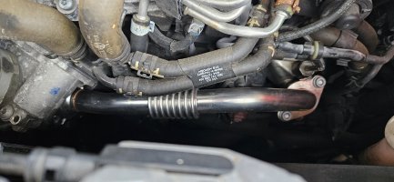

I had very similar symptoms, and air intake leak reported on my obd scanner. It was the front egr pipe. One of the flange joints had failed. VW replaced it with a reinfored design. A one-hour job as long as the bolts dont shear. The workshop supervisor said they are prone to failing without warning. Hope this might help when you get to investigate yours

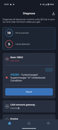

Took Cali round to block to get screen shot of the error and it had changed to turbo under boost.
Drove to my local garage (not VW, but are very good) to get it booked in and again the error changed back to air intake leak.

When my egr pipe failed I also got that same turbo underboost code intermittently.
