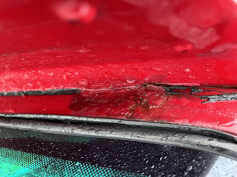

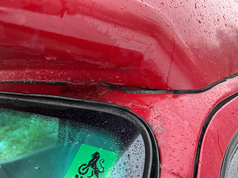

I'm looking for photos of other California Exclusive roofs where the bottom of the roof meets the top of the windscreen just to compare the state of mine.
I've got the common T4 fault where the windscreen leaks water into the footwell. I've had this on my Syncro back in the UK but the crack had propagated back from the windscreen and up the factory seam seal in the top drain channel. I've got a feeling this might have happened here due to the state of the seal at the moment which is why I want to compare.

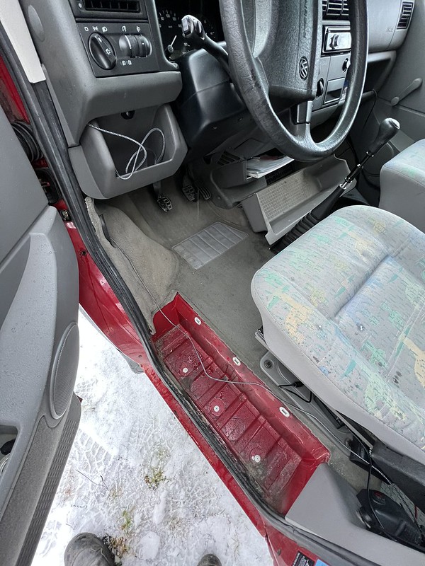

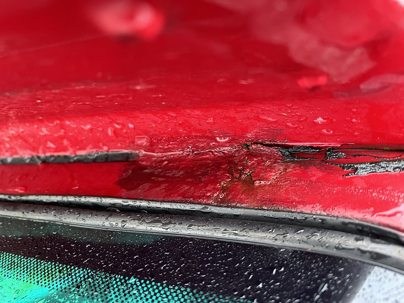

The carpet was all soggy under here!
