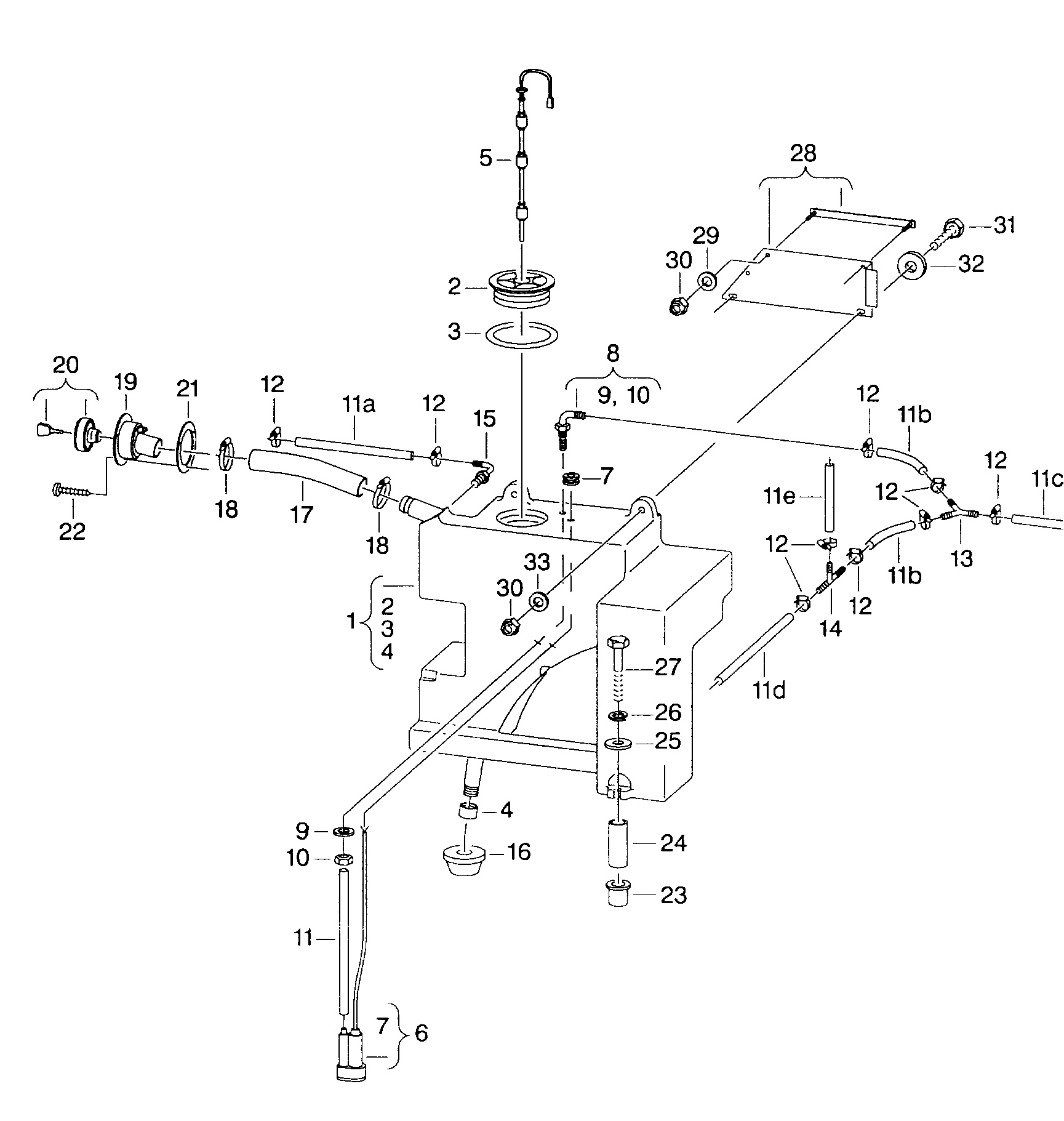

http://www.oemepc.com/vw/parts_lst/...998/hg/0/catalog/vw/drive_standart/132/lang/e
Scroll down to ' Water Supply System "

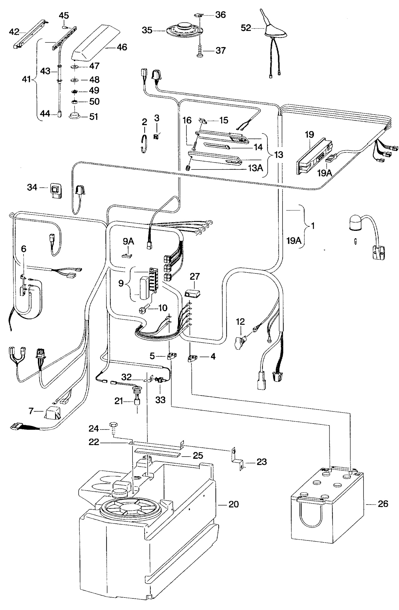

Was there any specific wiring diagrams for the exclusive? I've got some generic ones but they are no help.

There is one on that link I posted.
