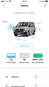

Connected mine after a few try’s in Nov2024 when I got the van new.(T6.1)
The pop roof facility is useful to close while outside monitoring.
Things then went down hill in March with refusal to connect at all.

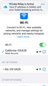

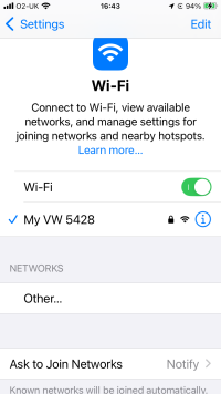

Recently did a reset of the Cali on tour app which is suggested for repeated unable to connects and now every other connection attempt works, the van doesn’t need the key in ignition and flips between the wifi/blue tooth connection of the van (My VW) and the California on tour app with the wifi system hotspot (See screen shot)

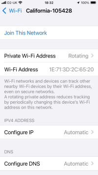

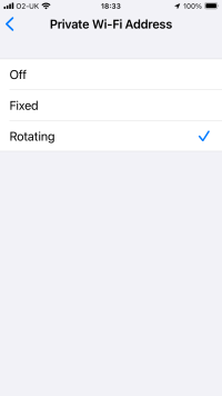

When I first set the app up on my iPhone I was getting nowhere until I toggled the Private WiFi address setting to “off” then the app could complete the setup whereas with the “rotating” IP address setting the app setup “fell over” as it was about to complete.
