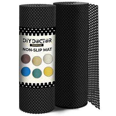

I put perforated material something similar to this at the bottom of the gas compartment (and also in the sliding drawer(s) under the bench seat):
I then wedge the gas bottle side with the supplied wedge plus various fingerless and full length work gloves all around around the side.
