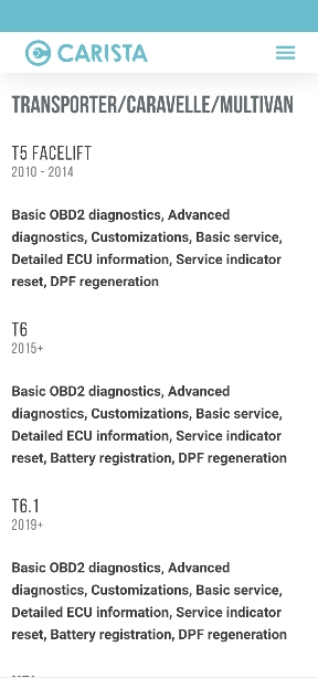

I was about to buy the carista to carry out a dpf regen and use it as needed for any future jobs on my van. I’ve read on here some folks says it’s compatible with the t5 but both carista website and +amazon+amazon+amazon+amazon+amazon+amazon say it’s not. Can anyone advise if this is the case. I have a 2008 se 174. Thanks in advance
Unfortunately, it seems it will not - as per the carista website ( see image)

But, being a bit cheeky, all vans built after 2004 were required to be OBD2 compliant. Get the reader , try it and if it does not work, return it to +amazon+amazon+amazon+amazon+amazon+amazon.
The app does allow you to use it for 2 weeks free.

If it connects I would be very surprised if it would start a DPF region on an older vehicle as that function is a fairly recent addition. It might work.
Just for information:-
Tried to instigate a DPF Regeneration using my Carista dongle earlier this week but it came up with an error message saying that communication with the vehicle had failed. Strange because running a diagnosis was working.
Anyway, had the option when the regen’ failure message came up to send a report to Carista which I did.
They responded and said that I should try starting the regen’ with the bonnet open and then drive at the required revs for 15-20 minutes.
So, tried it again today and sure enough it worked.

Not sure if this a T6.1 specific thing GG, but Will mentions in this video that the bonnet needs to be open to make any changes with Carista. Odd eh?
Bit odd yes. Bit inconvenient for a DPF Regen too.
On a 6.1 the ECU has new security protection to prevent programming unless the bonnet is open, but once you have instigated the regen you then need to close the bonnet for it to complete.
Might be as simple as VW setting this parameter to ensure that the vehicle is parked (although speedo would do that) in a service mode.
Definitely no need on T6.
Yes. Here’s what Carista advised:
Please initiate the regeneration in the app while still stationery with hood opened and engine working. Then close the hood and start driving for 10-15 minutes above 60 km/h (40 mph) while keeping engine RPMs around 2000-2500.
