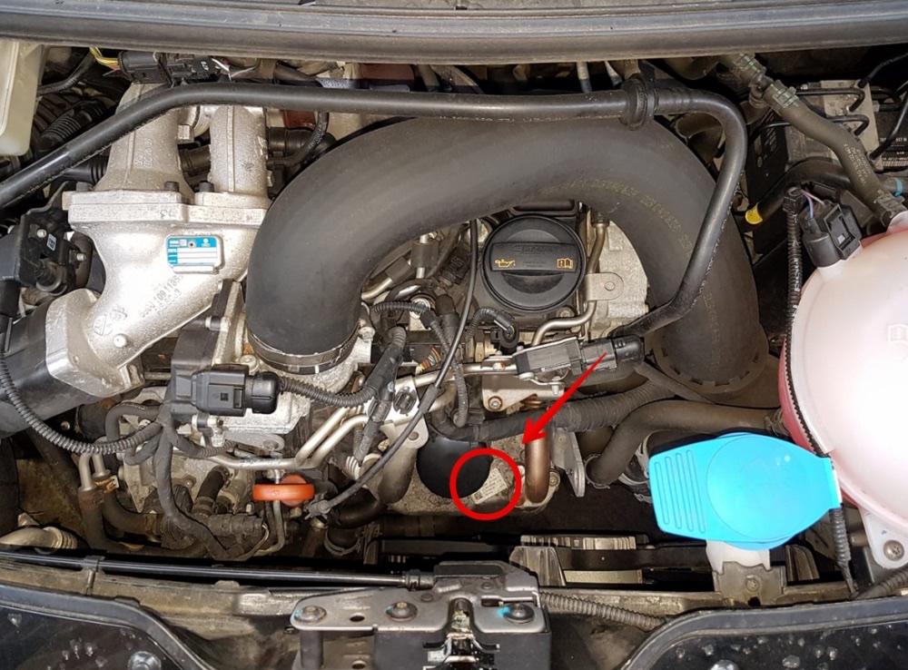

Worth checking your oil cooler part number. If it ends with ‘D’ you’re running an updated version which should be ok.
If you can't see it, take a photo, like this:
Thank you - I was about to ask where it was, then I opened the response and there it was.
Looks like I could be in trouble.
Did you mean EGR cooler?
If you want to know more search 180 EGR, lots of info.
