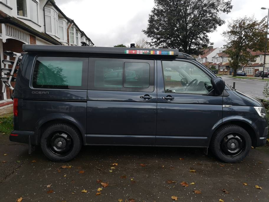

This is still one of my favourite photos. I drove to Samoen a month after getting the van to go skiing with my eldest daughter. I’d never driven that far before. The steels worked for me! B3C4686C-9761-47C0-A322-C2FFEF6FC631.png

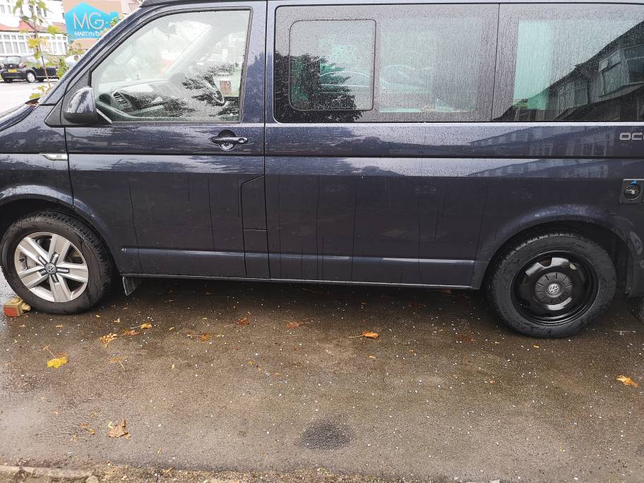

Those are not the gratest looking things, I agree. (although you probably mean the 17" steel rims)
But this is just a tad worse I suppose:
