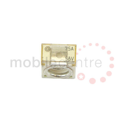

However having such a difference in the two batteries, could be due to a burnt fuse which prevents the charging of one of the two batteries.
The two batteries must be replaced by two exactly identical new ones. And this fuse must be checked to avoid quickly killing your new battery.

Look here for the fuse:
https://vwcaliforniaclub.com/threads/fuse-on-positive-leisure-battery-terminal.19122/post-219266

I have just checked and the fuse is blown on the rear battery. I will have to source a new one from somewhere.
