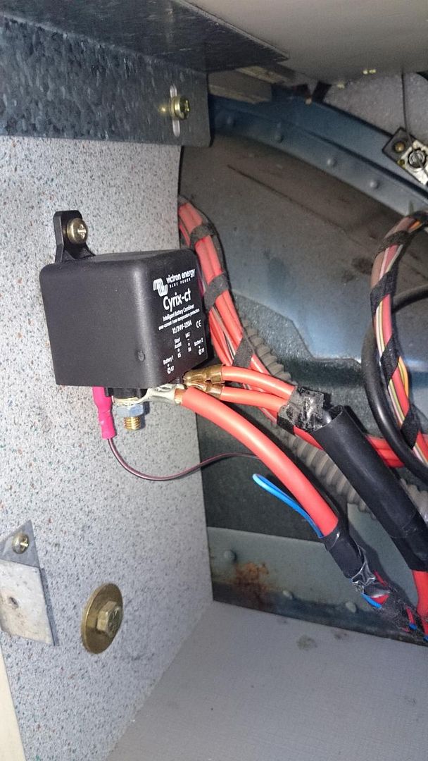

Ok, so I confirmed my charger is not the dual output kind, nor does the split charge relay divert any charge to the starter. So I bought and fitted one of these:
http://www.victronenergy.com/upload/documents/Datasheet-Cyrix-ct-120A-230A-EN.pdf (120A Model)
from Travelvolts.com. This will now combine the batteries and charge whichever one needs it from whichever source. Great bit of kit, I had one on my old panel van conversion.

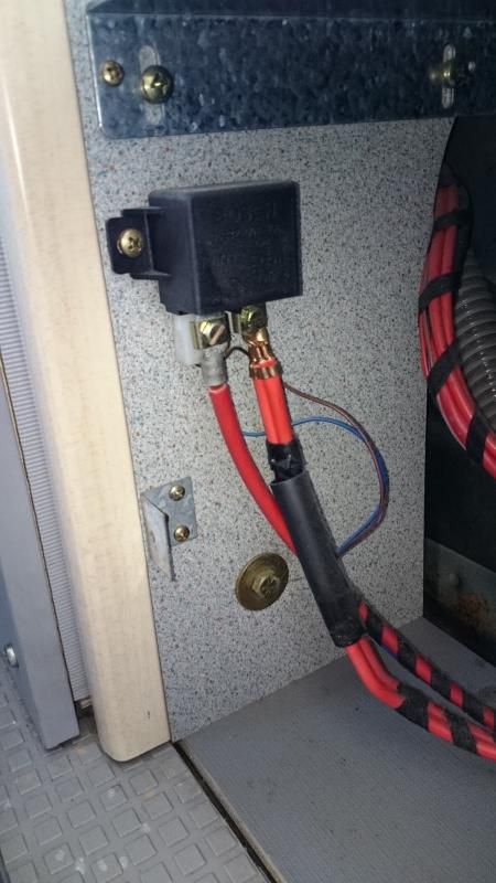

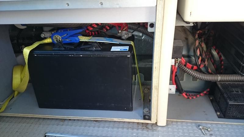

Some photos and installation notes for anyone else interested.
Beware before you start:
Cyrix has M6 terminal posts. Bosch relay has M4, so the only fiddle with the job is either cutting off M4 ring crimps and putting new ones on IF YOU HAVE THE CORRECT TOOL for the heavy gauge wire. Or very carefully filing out the terminals to M6, removing no more than you have to.
I would advocate the former, but actually did the latter.
Job was along the lines of
- Disconnect Starter Earth - Very Important!
- Disconnect Leisure Battery Earth - Very Important! On 2001 pop top it's easy to get to. No excuse.
- Check both terminals on existing relay ~0V with a voltmeter.
- Remove old relay. Starter +ve on the Right. Leisure on the Left.
- Fit new relay.
You'll need to reshape the positives because they are now going to point out the way from the relay.
You can reuse the existing plug for the earth. The Blue wire is no longer required. I clipped it, insulated and tied it back and crimped on a single spade connector, this would be optional.
- Refit earths
- Test everything works
I'm yet to determine if there is a difference in "priority" between the two terminals on the Cyrix. Will update this thread when I find out!
