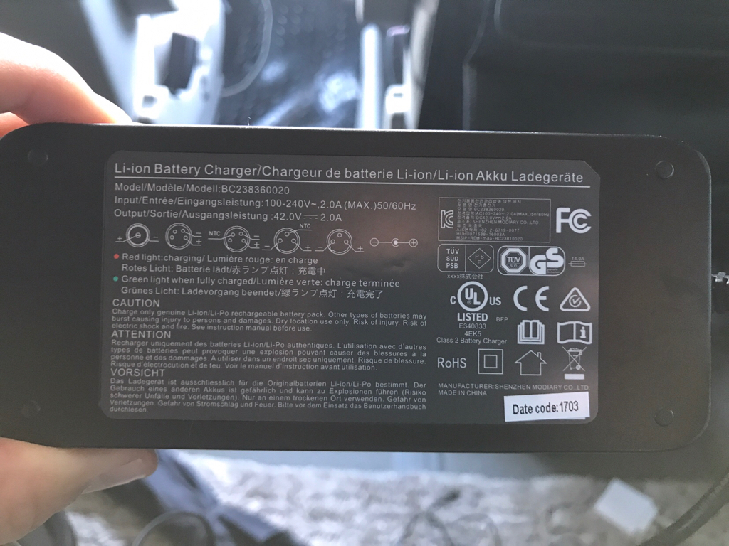

Just looking for a bit of advice for charging a couple of electric longboards.
I've included a pic of the charger for input and output power info.

I am no electrician but that appears to be a 42v output, I've never seen a 12v to 42v inverter/converter and a quick search turned up nothing of use. Doesnt mean its not out there but may be hard to find.
You could try a 240v inverter, but converting the 12v to 240v to 42v may not be very efficient. Input required is 240v at 2amps which would mean 480watts of power? The built in inverter won't be upto that. That would need a heavy duty inverter for that and may strain your battery (if it was possible). Someone more qualified may be able to confirm that as mine is an uneducated guess..
(Output is 42v at 2amps = 84 watts).

i think this is not going to be easy. Mains Charging would be the best option.
There is a Chinese company that makes a DC-DC 12-42v charger but only for trade orders of 100 units.
http://fuyuang.en.made-in-china.com...n-Battery-42V-2A-Balance-Scooter-Charger.html
However you do it I think you should use the charger that you have shown, presumably the one that came with the longboards.
Lithium ion batteries can be very touchy re charging and can catch fire or even explode if not charged correctly.
The charger will be matched to the batteries and will be safer to use than some sort of put together system.
You are only delivering /requiring 2A so I would connect an inverter to the auxiliary battery through a voltage sensng relay . Set the VSR at say 12.3V switch off and 12.5 switch on then when there is any spare energy form your solar panels it will run the inverter and your exisiting charger . If your worried about flattening your leisure battery perhaps just add separate panels and a small gel battery to load smooth . I'd be surprised if a solar panel would run an inverter directly
I’m going down the route of a Victron 500W inverter connected to the auxiliary battery under the front left seat. I have solar and like the idea of riding on sunshine alone.
