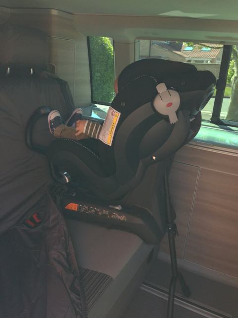

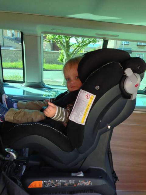

UPDATE: it was time to replace our son Bens infant carry system with something a bit larger.
In the end we opted for the BeSafe X3 isofix combi which is a rear-facing seat good for up to 18kg (so about 4 years). This is one of the few isofix rear-facing seats available in the UK. It can also be swung around as a front facing seat anchored using the belts if we find ourselves without isofix available.
We got it from Jeff + Baby & Co in Bristol (Keynsham) who were just excellent. Jeff asked us to pull up outside the back of the store & showed me how it fits in the Cali (the isofix points are tricky to locate!) & then instructed me on how to fit properly. We asked Jeff for his opinion on the BeSafe & he replied that he puts his boy in the same seat. Enough said.
Its no less practical than a forward facer IMO & offers way better protection than these, even at very low speeds (see the link below). Plus Ben feels like the king in it lol
With the headrest plopped down he can see straight out the back too :)
