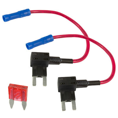

I've wired a socket that does switch off when the ignition is off. It also avoid wipes dangling everywhere. I just used a spare fuse slot that was switched live.
Where did you fine this spare slot ? I thought there was none. Could you give some more details about this connection? ?
Have a look at these dash cam posts. I used the same piggy back connections others have recommended.
And for the connection of the negative wire? On any screw connected to the body?
I ran a wire under the carpet to the seat fixing, but someone else found a suitable screw in the fusebox area behind the bottle holder.
Agree, there are screws under the dash that will give you an earthing point. There are also some holes in the metalwork near the fuse holder. I just used a suitably sized screw in one of those. Works.
