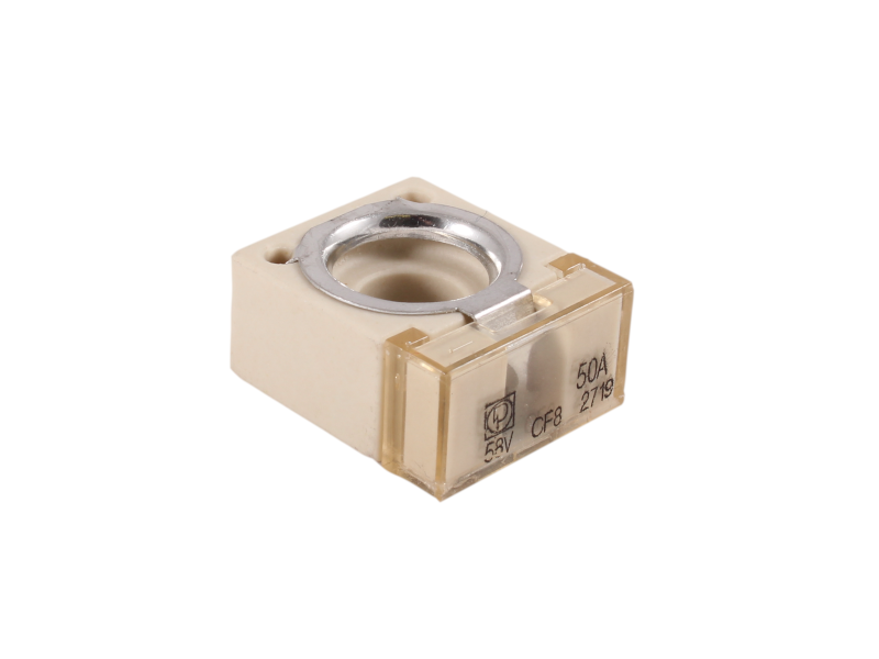

Yes! The flashing symbols have gone, hallelujah! Now I just need to fix the water pump and find a replacement cube fuse for the leisure battery. Almost impossible to buy anywhere. Any ideas?
