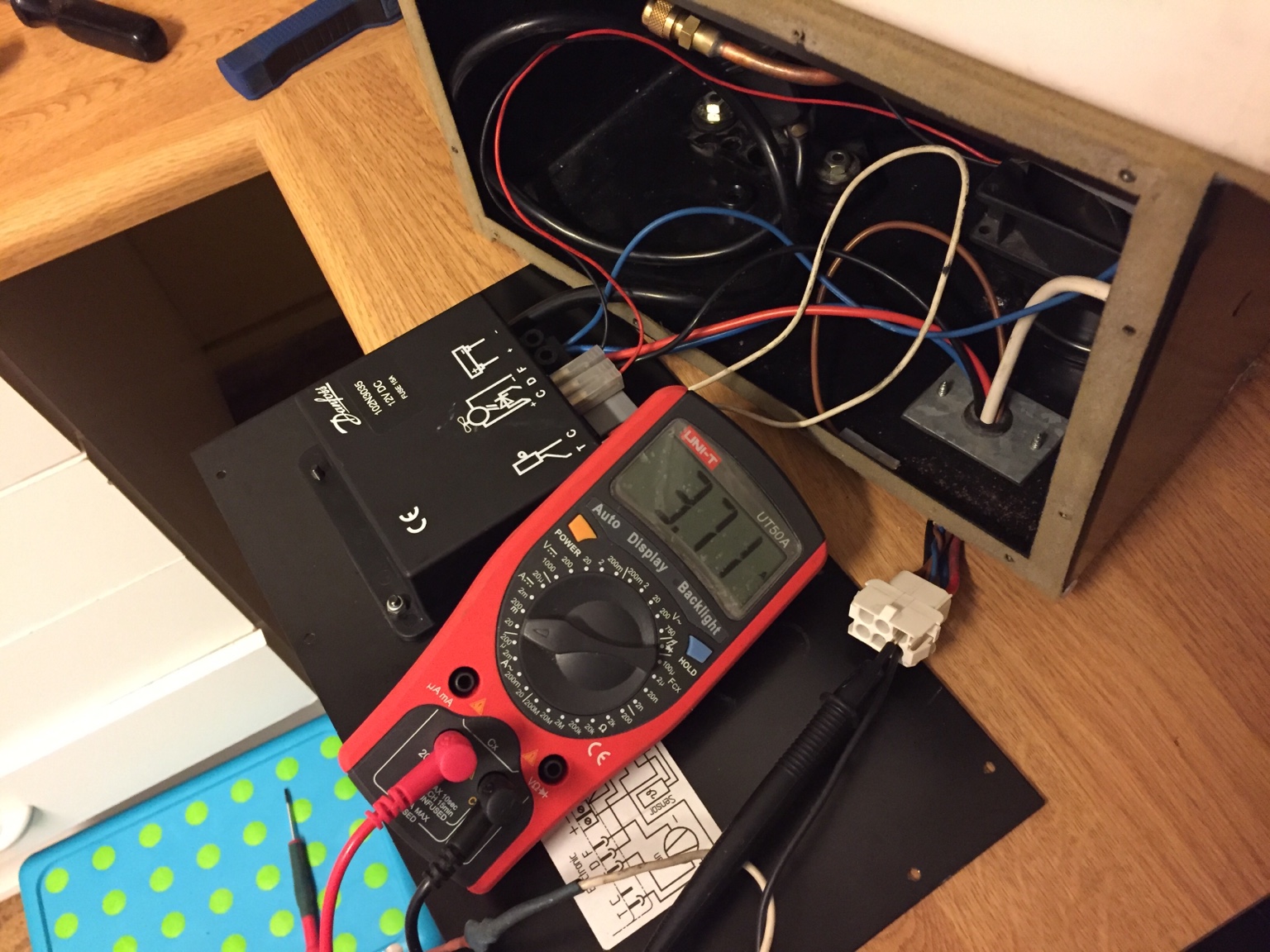

ArcticMatt did you ever get an expert opinion on the fridge? I have a similar situation with the fridge apparently running but no cooling happening. And the sensor seems to be reading right. Wondering if it's worth pulling the whole thing out to send away or whether I should start off by having the electrical control unit tested instead. Be interested to hear your experiences.

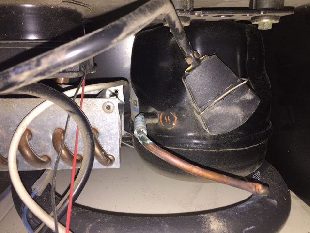

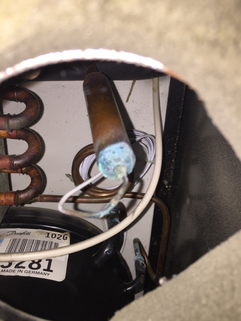

Hopefully getting it into a fridge specialist this week now that I'm back in Norge. Took the bottom off it and found quite a bit of green so I wonder if there is a little leak in there.

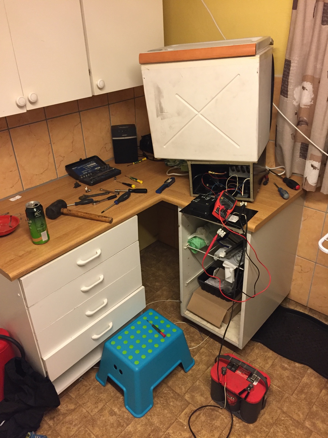

If it ever helps anyone, this is what the fridge looks like totally stripped down. It's at the refrigerant place now so I'm waiting for good news. It was initially drawing 4 amps at start up but then it drops down to about 3 after a minute or so.

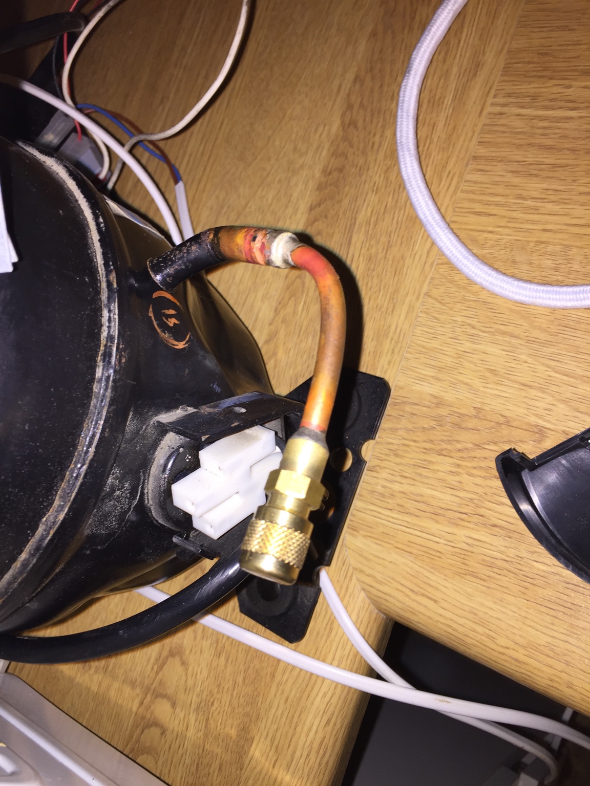

Proff-Teknikk of Fauske finally got around to recharging it. They couldn't find any leaks so it must have just died after almost 20 years. All for the grand total of 1175nok (£108). I managed to get it all together apart from losing one of the rubber feet for the compressor. Currently cooling one carton of orange. Now I've got to get the lump back in. It's still only drawing 4amps but it's not dropping off like before. Phew!
