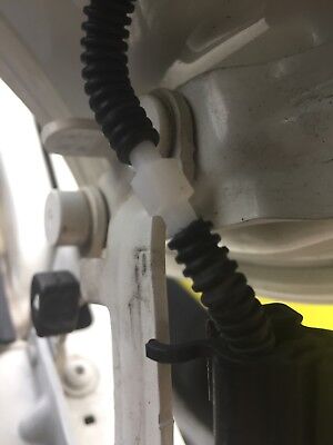

I had this problem several monthe ago.
I cut out the 1/8" that had worn through and through which the screen wash was pouring.
I found on the internet small joining plastic bits about 1/2" long which could be pushed into the two cut ends of the corrugated pipe. It was one hell of a fiddle and took me about half an hour and sprained fingers.
It cost pennies and has worked just fine.
It'll come apart one day but I have a spare
I think I googled something like "vw california worn screen wash pipe"
Here it is
