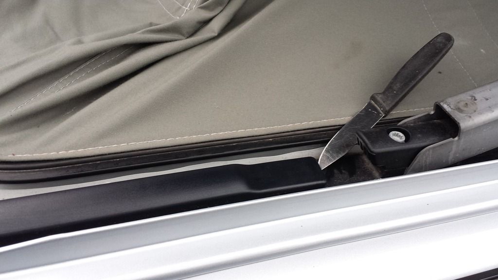

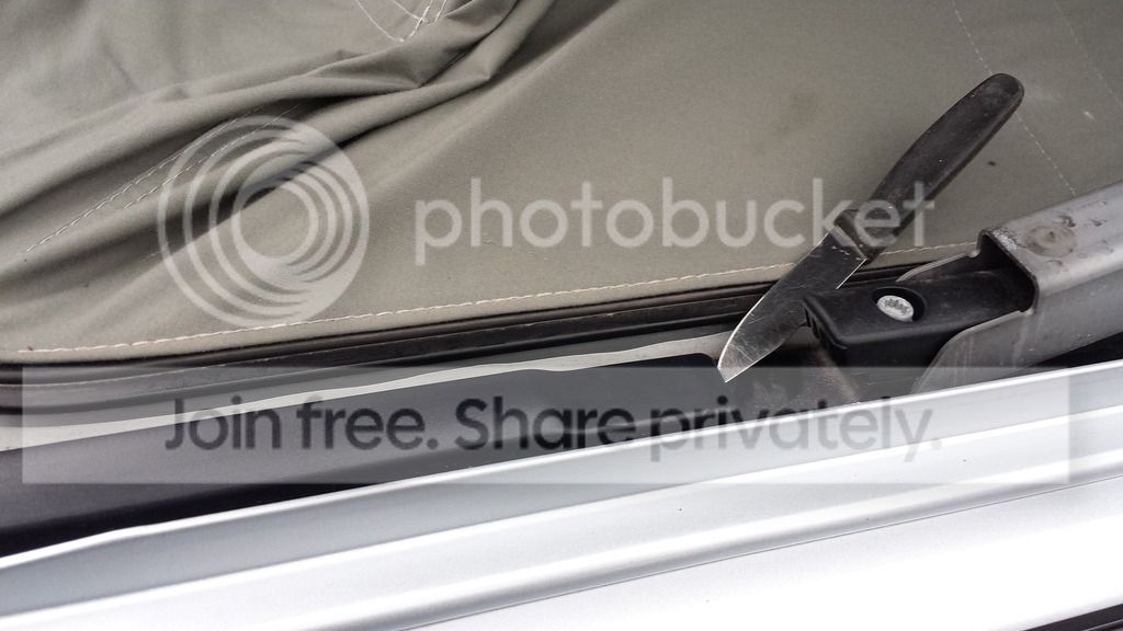

If you want to remove the black plastic covers that go over the front drain holes where the roof lifts to check for blockage or corrosion here are some images that may help.
Use a blade or thin screwdriver under the rear of the cover. You are trying to lift the round part of the molding out of the recess around the screw head so lever it vertically the front end slides around the rubber block and again lifts off vertically.

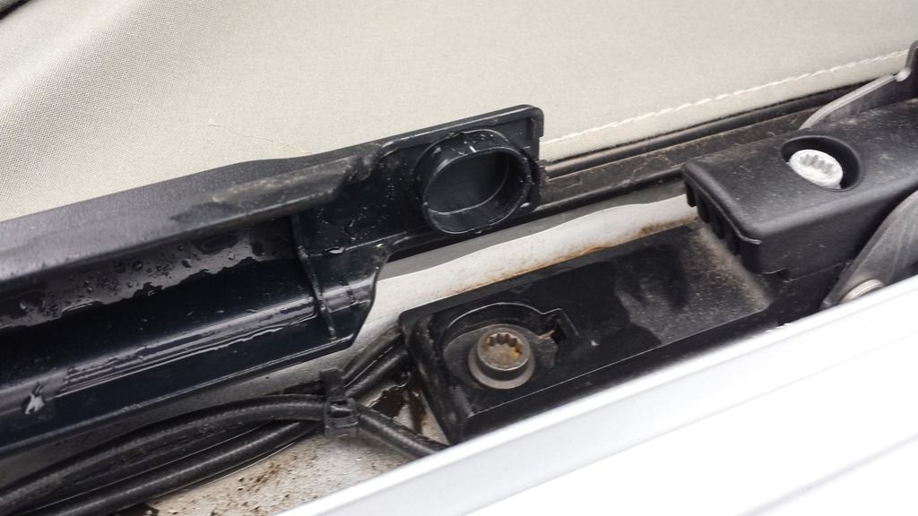

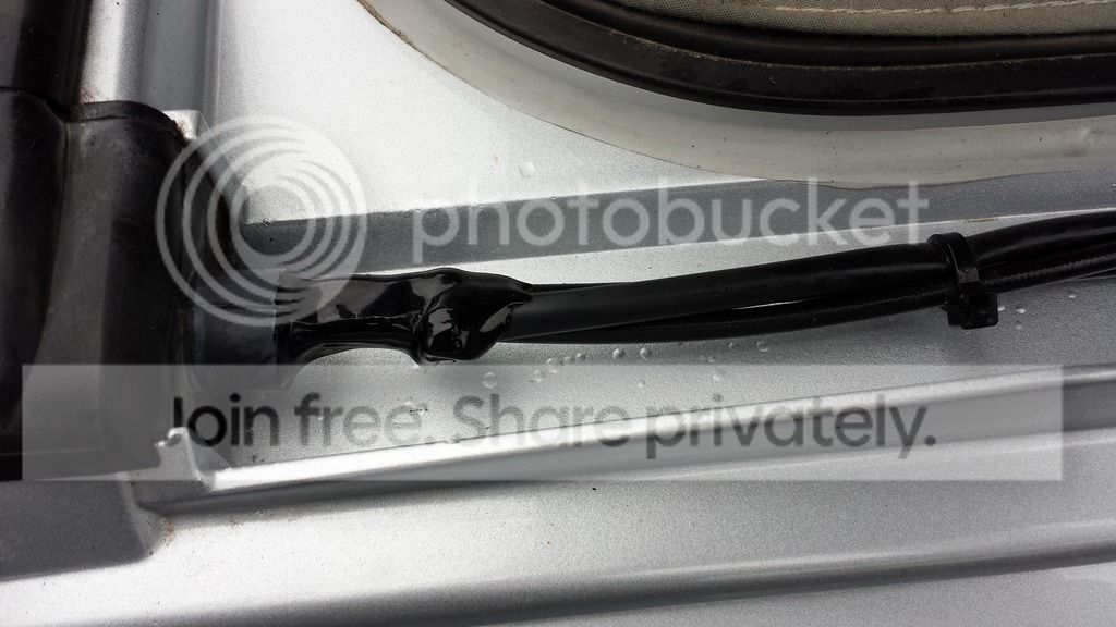

The drain hole is at the bottom of the rubber block. Also showing corrosion bubbles.

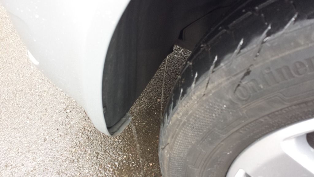

If you pour water down the drain holes, on mine it goes onto the top of the front inner wheel arch cover on which ever side and then runs out at the front.

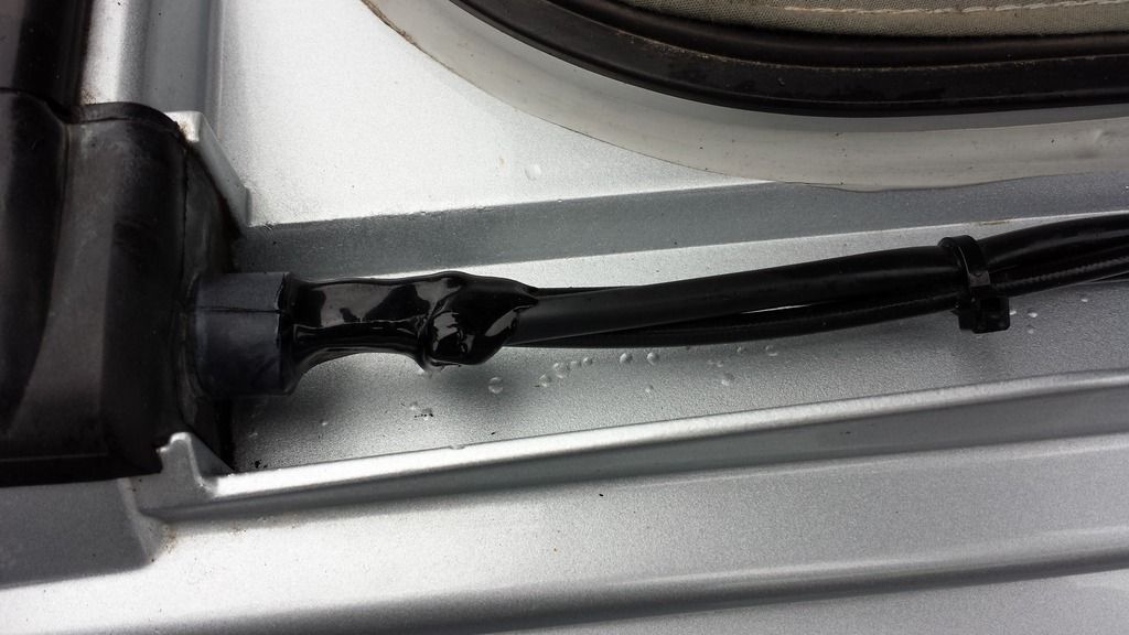

The frontones drain thru a rubber tube down
The rearones just end up between the boothdoor and the body , water just poors down from the back , just open the boothdoor and check if light comes thru with the pop-top up .....
