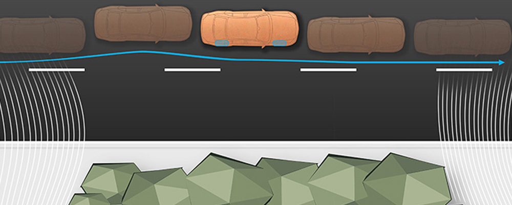

Did a little digging on this - like a lot of VW assist systems it's always more compex than it needs to be.
Cross wind assist (called side wind assist in EU) is standard on all Calis (and 6.1s) from at least Jan 2020.
The option itself is std when you look at the spec and it's just inbuilt with ESP. The only indication it is doing anything is if you are driving in wind and it kicks in your ESP light will come on momentarily while it corrects. Then it goes off. You may not feel anything. You don't switch it on or off, there is no menu option that details it.
It's not clear if you switch ESP off it also deactivates, but one assumes it does.

See my link to the press release from 2020 above and the options. It's there but I think your question is "brake assisted?" - the (silent) videos from VW on YT show braking on the video, which is more to ESP and is effectively how side assist works. See article.
I'm not convinced you would see it separately in the ODB if there are no parameters to modify.
I think the OP was asking if they have it - they have, it's std equipment. Exactly when it works seems less defined.
Yes, from that it looks brake based:
Cross Wind Assist
The Transporter 6.1 is equipped as standard with a new Cross Wind Assist feature. When the vehicle speed reaches 50mph, Cross Wind Assist is automatically activated. It then continually monitors the vehicle and its direction of travel. Should there be a sudden cross wind, the system uses the Electronic Stability Control programme and targeted braking of individual wheels to steer against it.
