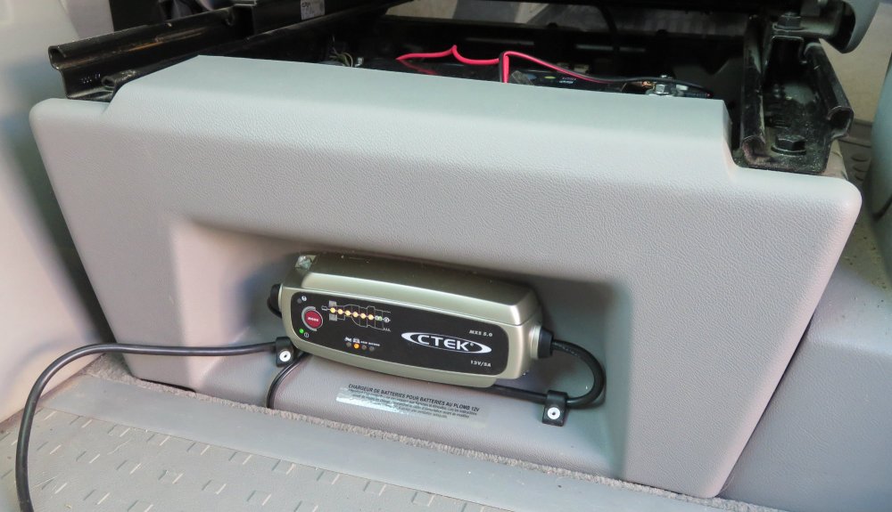

I've got a CTEK mxs 7.0 left over from my Defender ownership days. Question is could I put this to use on my Cali Beach?
I'm looking at purchasing an 'indicator' bolt on connector loom for the battery. Does anyone know the M6 or M8 bolt size please? In my googling of this subject, i'm confused.com. Do I attach the loom connector to the battery under the bonnet, or does my van have another battery under the front passenger seat. I've seen a company that mount a CTEK on the seat rear trim panel.
All help is gratefully received.
Cheers Al

I had one in my Beach to keep the aux battery charged. Fits nicely on the seat base.
I’ve mounted mine under the drivers seat out of sight. You need to get the longer lead and connect to the leisure battery under the passenger seat.
It’s wired so that the charger will charge the leisure battery when the van is connected to 230v supply at a campsite or home.

The panel at the back of the seat just pulls off. Easiest way is to slide the seat forward (as in the photo above) and grab the edge of the plastic now exposed and pull/pivot the top towards the rear of the van. It doesn't take much force. Once removed you will see a rubber cover over the leisure battery (so that answer another question :thumb).
I have also fixed an MXS 7 Ctek to the panel. The 7 is bigger than the 5 pictured earlier so I had to fabricate a false front to the panel. I fitted a Ctek comfort connector (ring to plug) onto the leisure battery and the output from the charger is lead under the passenger seat and plugged into that comfort connector. (sorry can't remember the ring size). Like this it will only charge the leisure battery. If I want to charge the main vehicle battery I unplug the comfort connector and plug in either a set of crocodile clips lead out of the window or more likely a cigarette lighter lead into the dashboard 12V socket.
