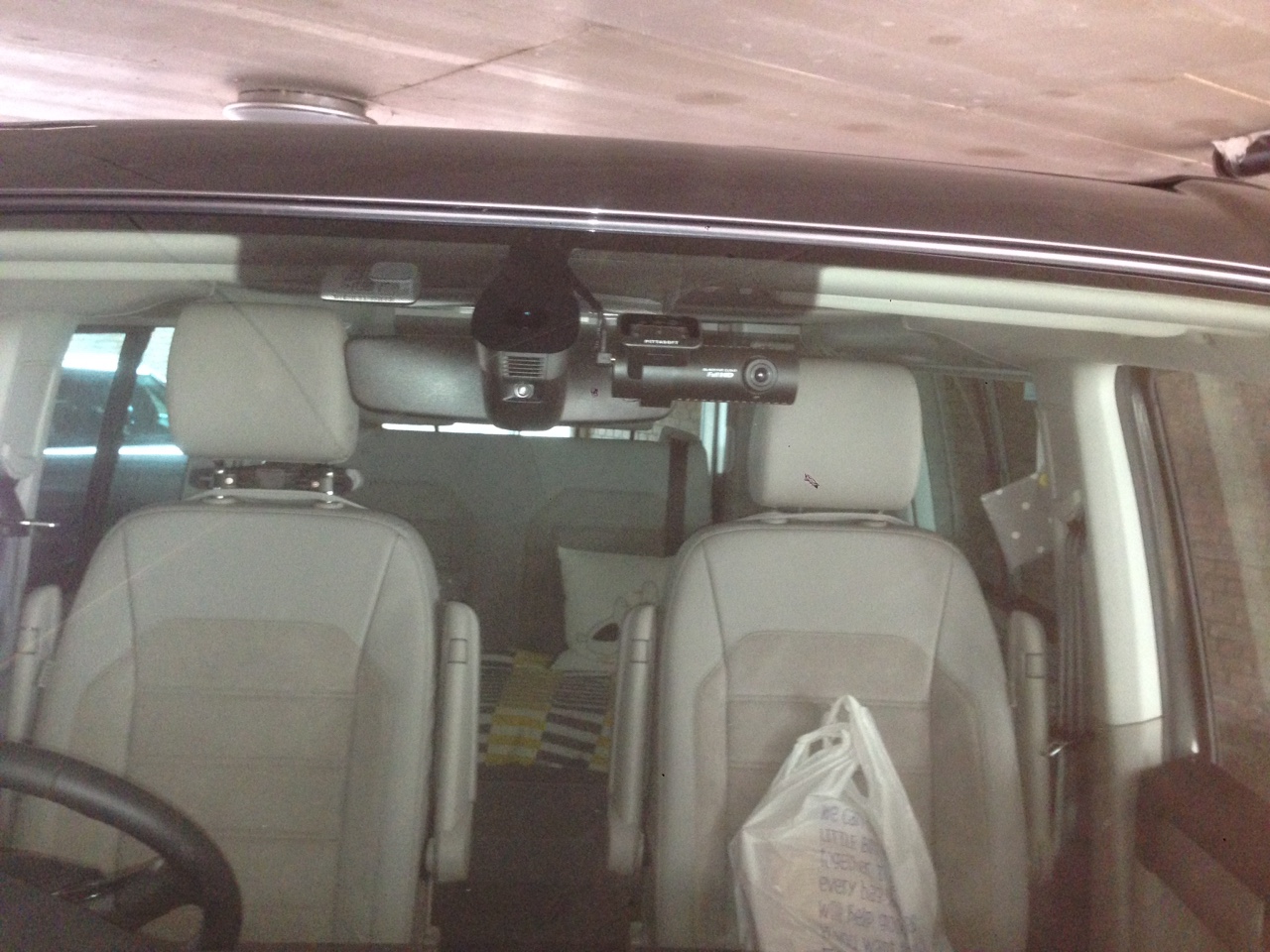

Front Camera

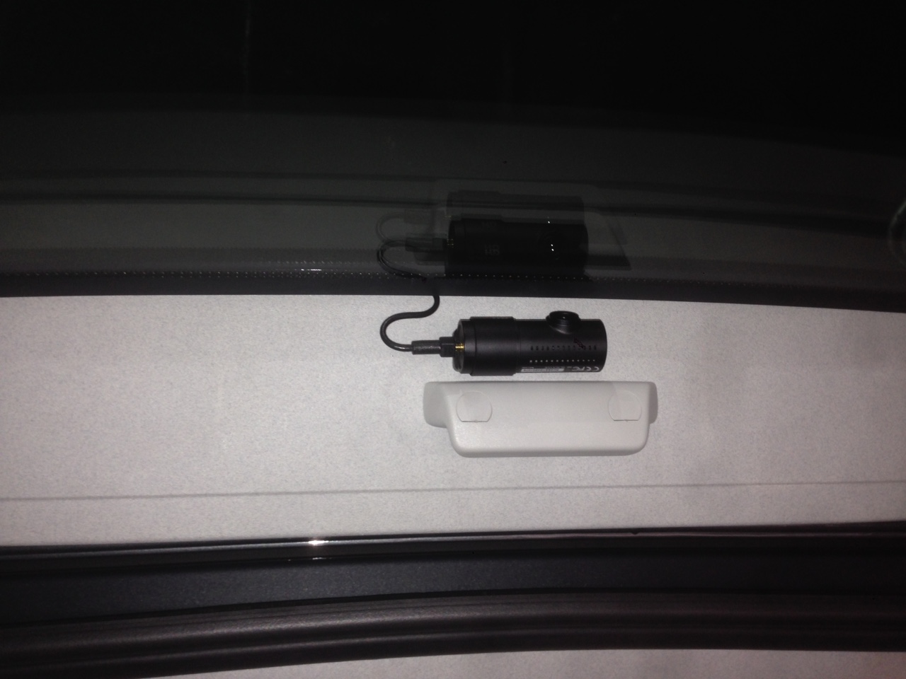

Rear Camera

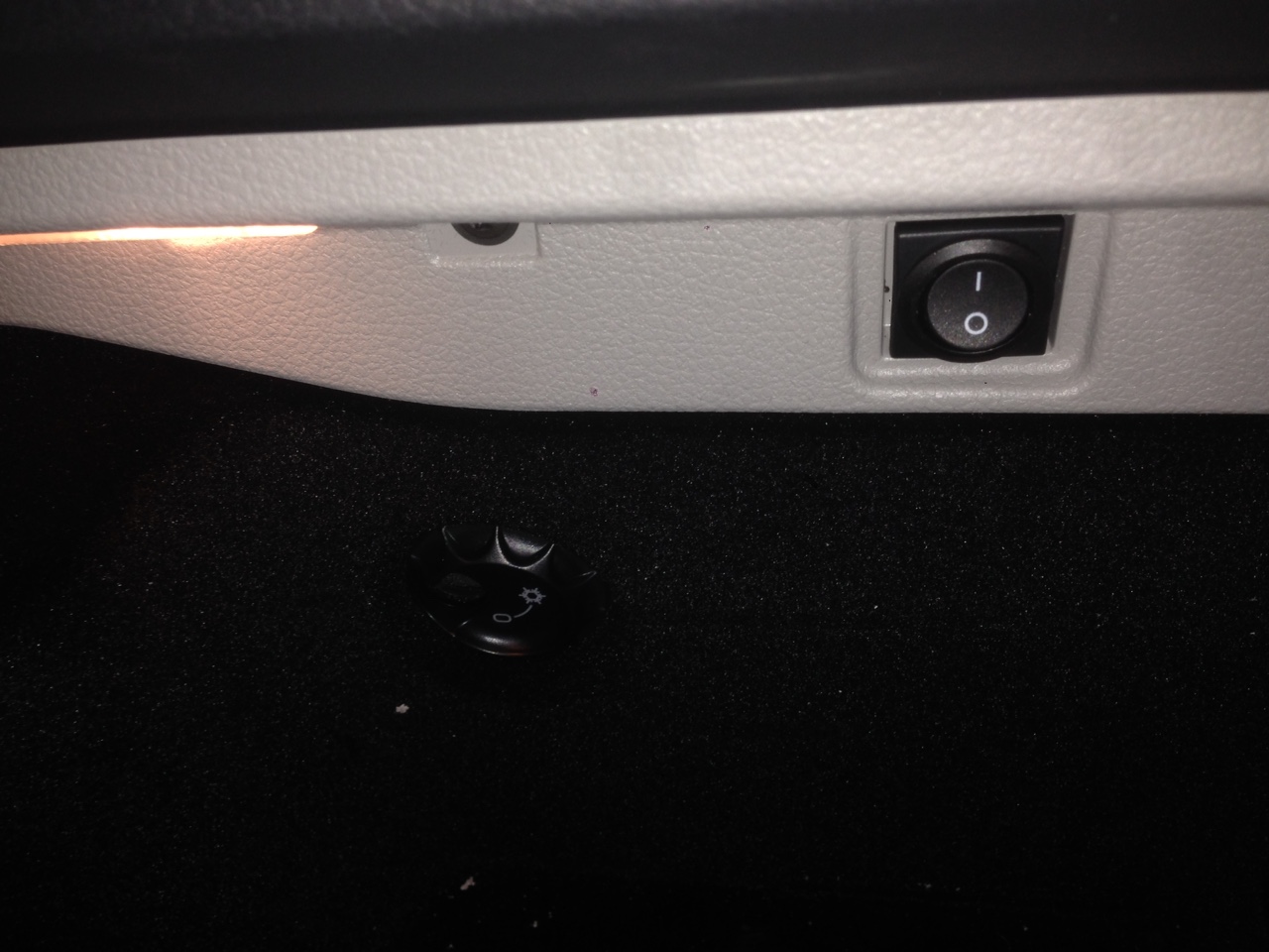

Switch in glove box

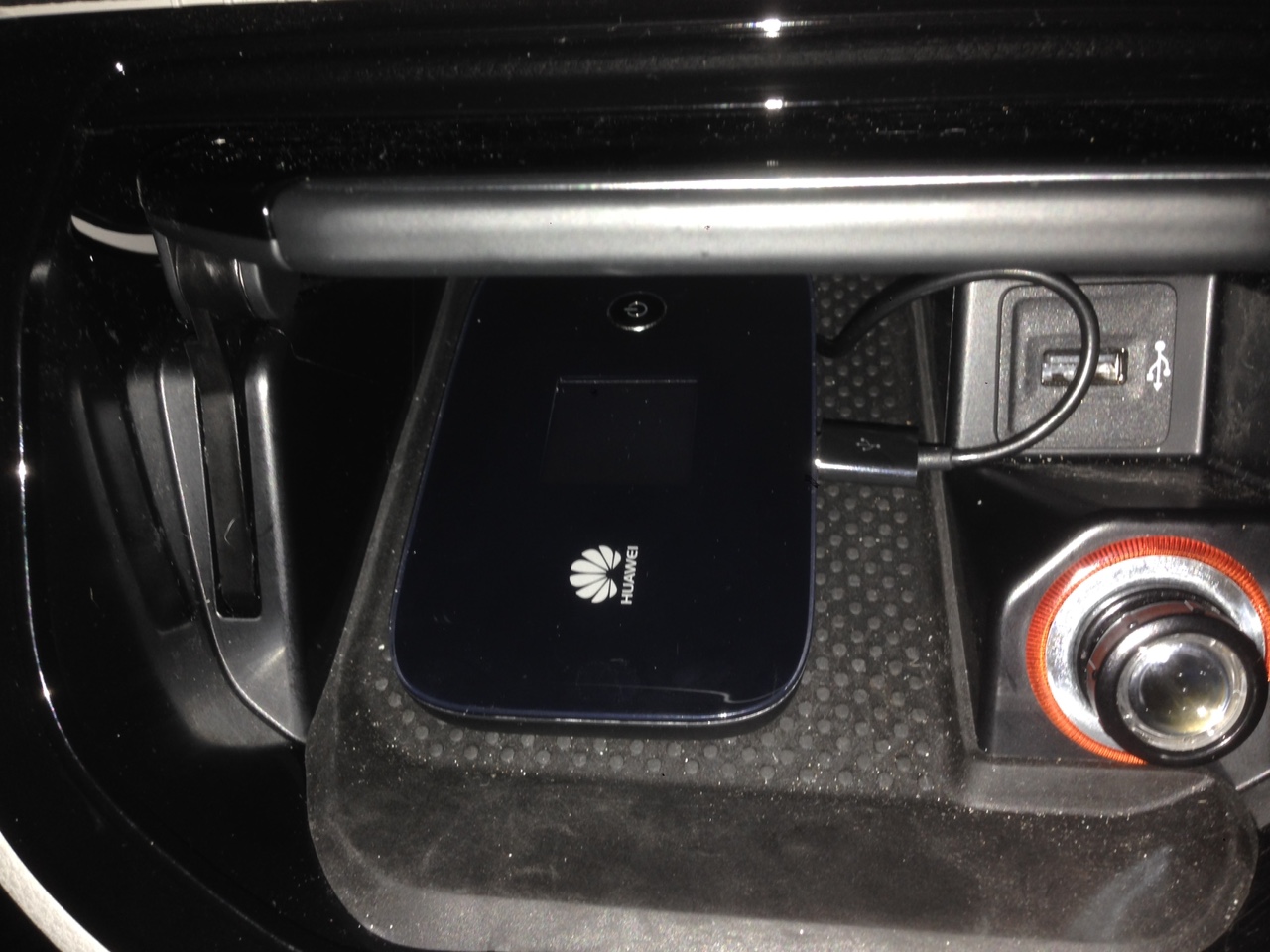

Mifi in phone cubby
