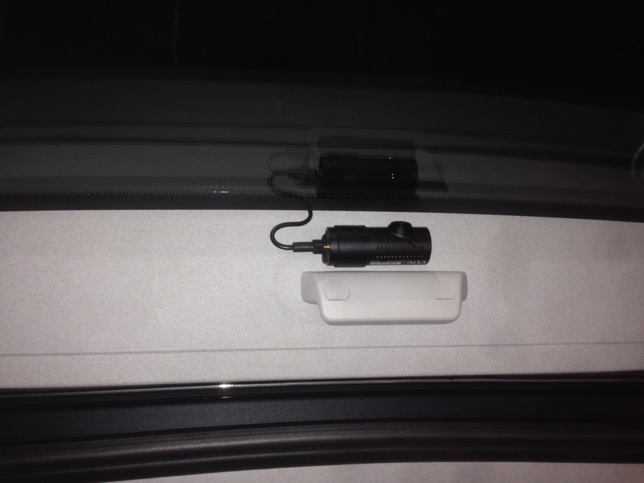

Most fiddly part they had was installing the rear camera. I put in a string beforehand so that they could pull the feed from front to back but the fitter got the wire through from there to the back screen using a fibre optic camera.

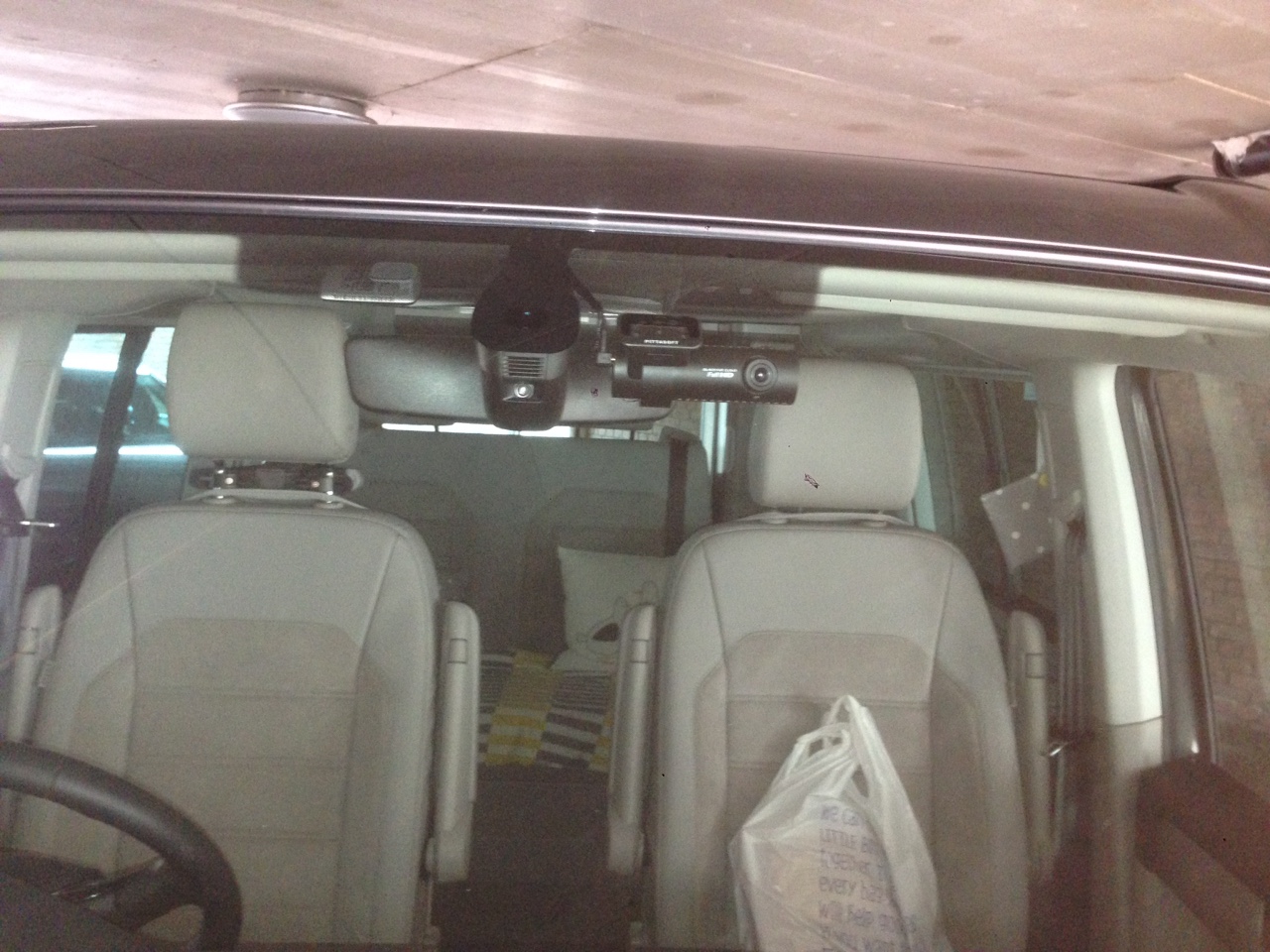

Front Camera
Rear Camera

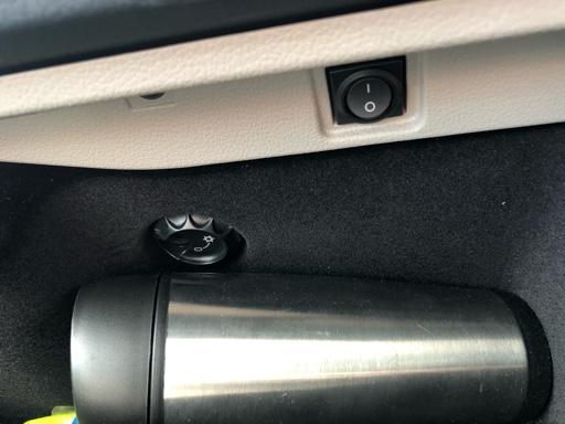

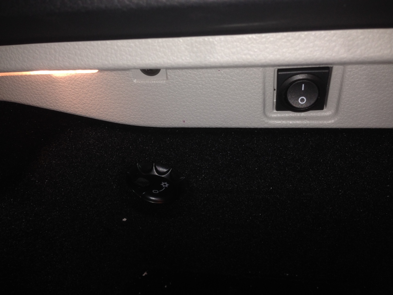

Switch in glove box
Mifi in phone cubby

Pic above is the switch in the glove compartment. Very tidy.
Front Camera
Rear Camera
Switch in glove box
Mifi in phone cubby

Can’t quite figure out the rear camera position. Is it attached to the head lining rather than actually on the tailgate glass?
