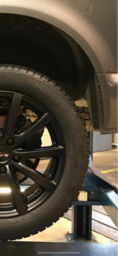

I run a set of Michelin cross climate 235/50 r18s on some cheap alloys. They’re excellent but I don’t want to run them all year.
Just had Nokian WRC 3 fitted 215/60/17 109/107T w.
