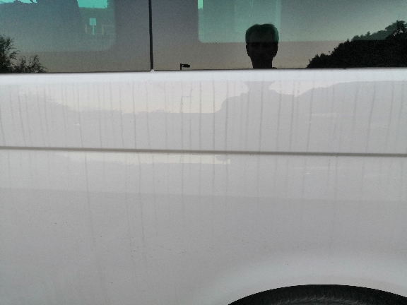

Hi all
Does anybody else experience these dirty streak marks.
Short of cleaning the cali every other day, is there something I should be doing?
Thanjs5
Sent from my COL-L29 using Tapatalk
Hi & :welcome
what your experiencing is the road film that build up in the recess between the window and bodywork.
the windows are bonded to the body shell
you can improve that by taking a clean rag, car wash solution, gently pushing the rag into the gap around the window and carefully move it around the perimeter aperture it will clean most of that off, then wash the vehicle as normal
edit see Mark up the arrows show the gap around and between the windows that need to be cleaned periodically, I’m sure you’ll get the idea. do not force the cloth into the gap, simply pucker it up enough to touch the glass and the body panel, then move it around the perimeter
