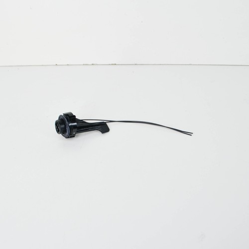

Can anyone confirm if the DLR holder 'repair kit' (7E0998953) just needs to be wired into the two grey wires beneath the DLR socket? I assume so... seems straightforward enough but hard to see properly given the lack of space!
For completeness & to help others,
I think this is the thread referred to In Your previous post (posted in your other thread ).
Thanks Perfecto. I'm hoping it's as simple as wiring in the new holder to the two grey wires shown above, being careful to keep the wires on the correct sides as I believe polarity difference can effect the bulb colour / brightness.
But it would be good if to hear if anyone has done this repair themselves - I don't want to pay VW £200 for something that a) appears to be a manufacturer design flaw b) seems like such a simple fix

I'll be ordering the repair kit and fixing it myself...
My dlr is the same ,melted contacts and not working,as it’s not an mot failure as the van is too early I think we will leave it as it is
Just to close this thread - my driver side DLR has been repaired and is working again.
I've attached a few photos. The fix is fairly easy - took me around 45 mins, and the part which is £38. No idea where VW got their £300 price from and assertion that the bumper would need to come off and headlight out - there was no need to do this.
I firstly snipped the two wires which go beneath the DLR socket as shown in the red circle.
I put a piece of insulation tape on one of the wires so I could match up the correct side to the new wired holder. I then did an initial temporary fix just to test the light worked OK.
I then did a final fix using a couple of butt crimps. The hardest bit is the lack of space to work, and the short wires you are trying to connect to.
Satisfied with an easy repair and +£250 saved!

to help others can you post the bulb holder part number and where you got it from.
No problem - the part is 7E0998953. I ordered mine from ebay as all the websites I checked were non-UK and charging crazy P&P prices (£18 to post!). The place I bought mine is now out of stock, but there are others on ebay for a little more than I paid:
From the listing : (auction listings have a habit or being removed after a period of time rendering the link unusable)
VW TRANSPORTER T6 Front DRL Running Light Bulb Holder 7E0998953 NEW OEM
