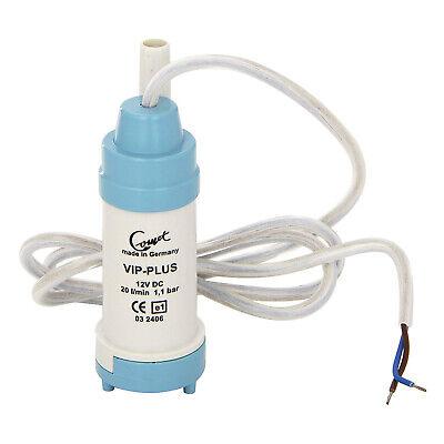

Hope this helps, here is the Comet VIP Plus Datasheet so you could always upgrade your pump to this version.
Flow max. 20 l/min
Pressure max. 1,1 bar / 16 psi
Current max. 3,8 A but I would always fit a relay to take the load off the tap microswitch :)
