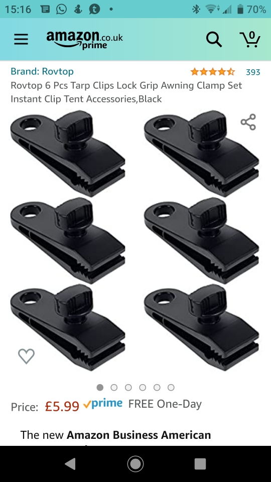

I have the Vango one, which is really natty, with it's own bag, however, does anyone else come back to their van with the some of the figure of eight having slid off because it is windy. Is there anything I can put on each end just to keep it from sliding? thank you for reading.
PS I have bought a Vango airbeam Palm, it is brilliant.
Had exactly the same issue and used 2 of these, either end on the awning kador strip to stop it sliding and not had a problem since

Where exactly did you attach these clips, to the drive away kador strip, and the awning kador together?
Usually the kador strip or the awning bead is longer than the channel in the van or the lead-bar, so I use these clamps on either end of the overhanging kador/awning sections to stop them from sliding either way...

that'll be perfect thank you very much appreciated, I also found recently at the Lake District that the figure of eight I used, when windy was moving all over the place, I'm using a Outwell Blossburg 380 with the Link Access Zone System, which is cool as it'll fit either left or right hand side door opening but did struggle in the wind when attaching it.
Hope this gives you the idea...
Can use at either end of the fig8, or kador strip to van, or both using 4 Clamps.

Wow, just stumbled onto this and also been looking for a solution to the ‘sliding Kador strip’ for ages. Off upstairs to the PC to push off hubby and order these on Amazon.
Thanks, this forum never fails to amaze us.
The Rovtop ones are Out of Stock( hadn’t noticed the post date, a while ago) , but hey ho purchased a 4 pack of Faithful Tarp clips, which look very similar at £7.95
