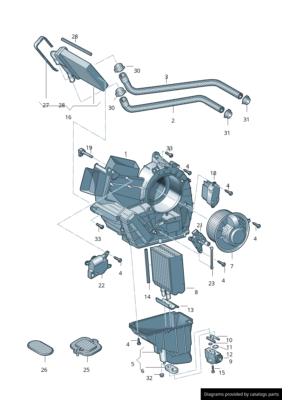

Part 24?
Website here.
Or here. Select Campmobile and year of vehicle
Thanks for the quick reply to my post @WelshGas. I've had a look at the website and actually think it's part 23 I need (coupling rod lever for temperature regulating flap) as it was cold air coming through the vents when the temperature control dial was turned all the way up; part 24 is the coupling rod lever for air distribution.
At the risk of stating the obvious I assume I can just go to my local VW Commercial dealer with that part no. (part 23 equates to 7H0819317) rather than order from a Russian website?

Definitely. I just use that site for diagrams and part numbers.
You should be able to get it from VW, or try Google or eBay.
I chose Part 24 because the Black part looked similar to Part 22.
