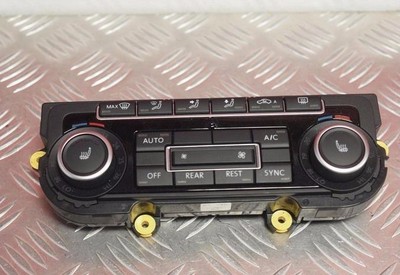

Interesting, my T5.1 climatronic has an off button, separate from the A/C on/off button. I've been checking pictures online and it looks like that was eliminated on the T6. Photo below is what I have.
