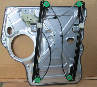

Straining noise might be the regulator cable; Used to happen on Audi TT's alot. The window gets frozen to the door frame during cold periods, when you unwind the window, the cable stretches as it pulls the glass off the ice and will eventually fail. If so, you will normally hear a strange crunching noise, which is the failed cable strands rubbing against one another under tension.
If you need a replacement, ALWAYS but a VW one...cheaper replacements are sometimes not as easy to fit and will result in alot of swearing!.
