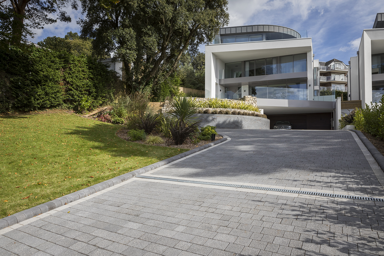

We got our bricks from Brett Paving.
They have a list of accredited driveway installers.
Having used cheap cowboy builders in the first instance, and having had them dump crushed concrete instead of MOT type 1 for a foundation, I’d recommend using an accredited installer from the outset.
