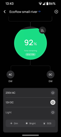

I don't suppose anyone knows if the Ecoflow River 2 has the option to toggle USB-C in the app?
I have the ecoflow River plus. Yes you can toggle all 12 volt functions through the app.
This is a very good piece of kit, I can use a kettle or toaster but it doesn't last long.
Thanks Gary, I'm thinking about Gordons USB-C PD battery charger solution and being able to control it, rather than the 12 DC outlet.
