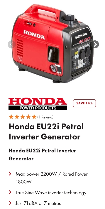

In terms of the standard GC infrastructure (power, water, and gas) I actually think the quality of both the components and the installation is generally very good for the amount of money you pay.
When you compare it with a bespoke 'off-grid' camper conversion, you are not comparing 'apples with apples', so it's a bit of a pointless exercise, especially when you factor in the cost difference.
I believe solar power packs are a good solution for a couple of days off-grid but not really much use in the UK where we don't get year-round sunlight. They are perfect for a winter lay-up in southern Spain or Portugal, for instance.
I haven't given this loads of thought, but probably if I wanted off-grid power, I'd go for a modern lightweight, super quiet petrol generator. I had a 4 stroke Honda a few years ago, and it seemed to run forever on the merest wiff of fuel. You, of course, couldn't run it if you had neighbours, but if you're off-grid, I'm assuming that you don't.
Just my 2p worth
Sent from my SM-G986B using Tapatalk
Here you go, this would be perfect
