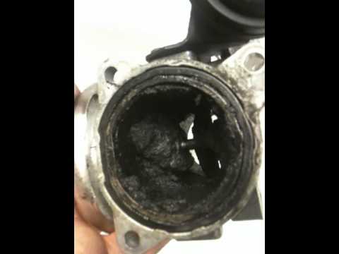

Alex is probably best placed to give details on the failure mode but I suspect like most others it's clogging.
The oily/soot deposits play havoc with them.

I found some pictures on google -

I feel sick just looking at that... :thanks. Wish I'd not asked now :eek:
