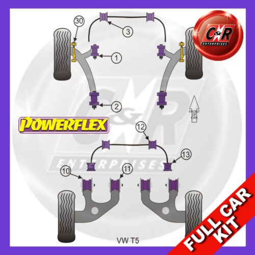

VW would normally replace the rear suspension bolts that adjust the rear wheel alignment, a VW practice that tracking garages wouldn't do.
If the budget permits I'd recommend having an adjustable Poly-bush set fitted to the rear as all bolts come with it plus you can have Camber adjusted in addition to alignment.
Again if budget permitted include a front set but could be done later as easier to do than the rear.

£225 for some bolts though? Not sure VW would fit the poly bushes and whether they would cause warranty issues (which is my overall concern here - as its 6 months old)
Warranty is related to the kit. Usually only 12 months on non manufacturer parts. May get VW period as they fit it.
Polly bushes are lifetime warranty. transformed the comfort level on mine and improved handling due to angles all being set correctly. Just a suggestion.
