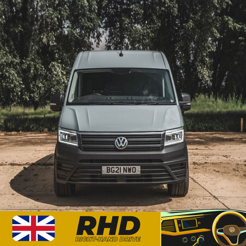

I had this one in mind, fitting the factory ones are way too expensive and complex as you need extra wiring and sensors, programming etc... With these I could do it myself, it would be just replacing one by the other:

As you think the headlight units will need replacing for standard Halogen units. LED conversion wouldn't be viable as self levelling and washers also needed.

Regarding the LED headlights, these are for any Crafter, excluding vans with Factory Fitted LED lights, and they won't need any sensor as they are meant to replace the halogen VW headlights.
These are the details from the HQ store
  • Any VW Crafter (2nd Generation) and MAN TGE – EXCLUDING VANS WITH FACTORY FITTED LED HEADLIGHTS
  • From late 2017 to current
  • PLUG AND PLAY
  • No Coding required, simply fit them and go!
  • No Error Codes, No Dash Warning Lights!

Ref bulb options on those, Halogen Osram H7 +200% are a good option. Their LED bulb option isn't road legal and if you have bulb failure warning that needs turning off.

If in doubt, give Transporter HQ a call, they are really helpful and know their stuff!
